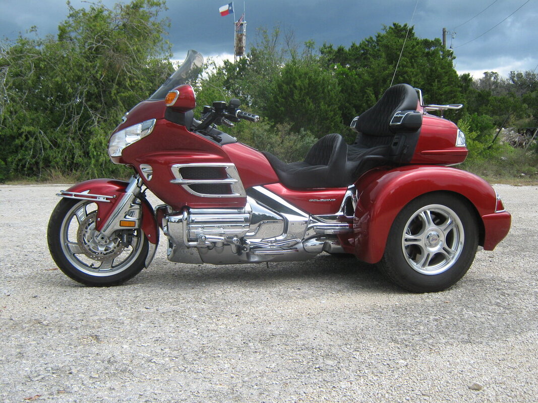

2003 Goldwing still has driver pegs. Want to install floor boards, also down and forward a bit. Do floor boards work on trikes and what do you like?

What would be weight bearing foot fairing, I have the Champion conversion. Is this something that can be bought?

I don't believe they do. If you look at the photos on their site they call these things "Lower Accent Panels"..... I don't see how a person could even use them as foot rest at all let alone be weight bearing.. :xszpv: :xszpv:

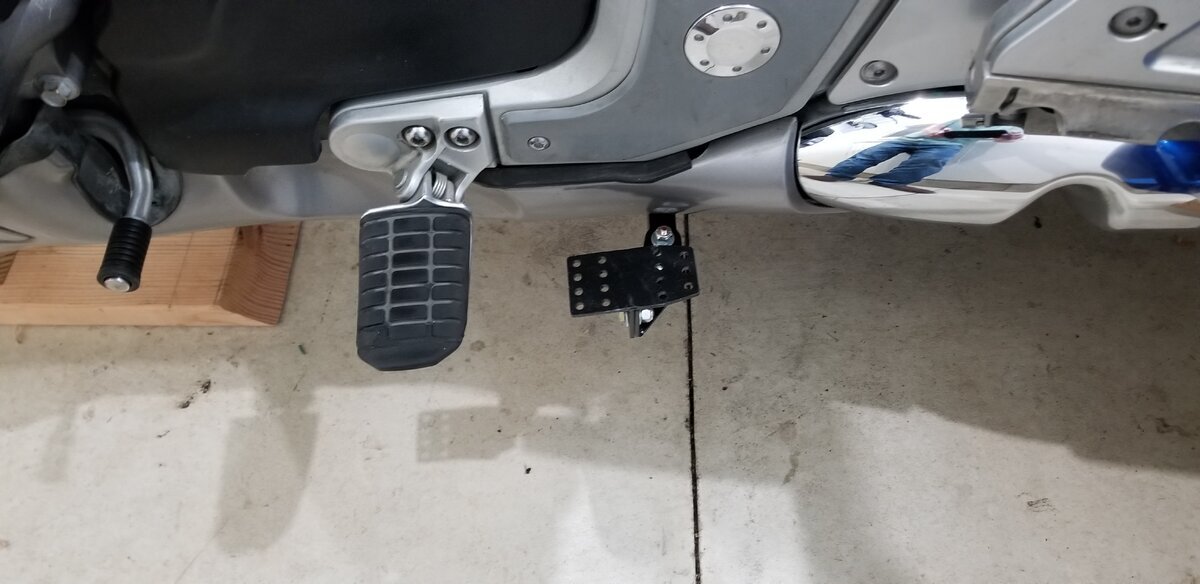

I have a Lehman Trike kit on a 2012 GL1800. The trike has weight bearing Aqua Shields and I installed the Kury floor boards with the toe heal shiffter as well. The trick here is on the Lehman Kit there are 2 different shape small brackets that replace the OEM supports that support the Aqua Shields attaching them to the OEM Peg mounting brackets. These brackets allow space for the driver boards to be mounted while still maintaining the weight bearing features.
I use the Kury boards to mount and dis-mount the bike. Champion which mow has purchased Lehman may have these addition brackets that would fit the Champion Trike. I can give you the Lehman Parts numbers if you wish. It may be worth a call to Champion to see if they would fit.

I just purchased the Champion Accent Panels for my 2012 and there is a square metal tube support that bolts to the frame where the main stand was attached that has mounting pads that are fastened to the inside of the boards when they are installed.Running Board Main Support  Bracket.jpg
