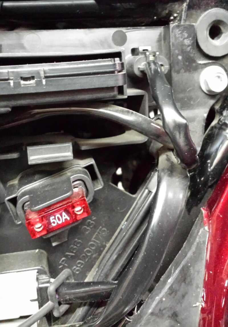

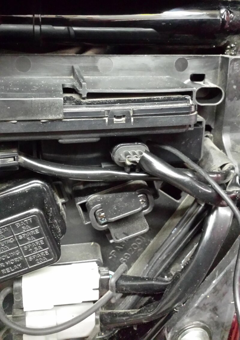

Factory security working?
The Siren plug is in the upper right ..... parked in a blank plug socket. (one pic shows as stock, 2nd with siren module in it's slot above the 50 amp fuse and plugged in)
The Siren module goes into the open slot below it.

I'm thinking you just like showing off that clean ride šŸ˜„! I noticed the missing 50A fuse in one picture.

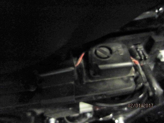

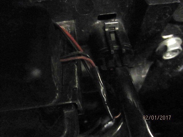

Details? Part number? Could you upload a shot of where/how you connected it and tied it/them down? Appreciate it...
Here is pic of siren .will try to find a part # They r side by side. Maybe 2x3 in. Just plug wires into the plug used for HD siren
