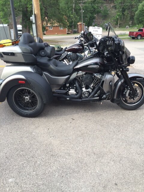

Ya, I gotta get the floor board extenders. Looks like a similar le job. Good call bike Looks good 😎

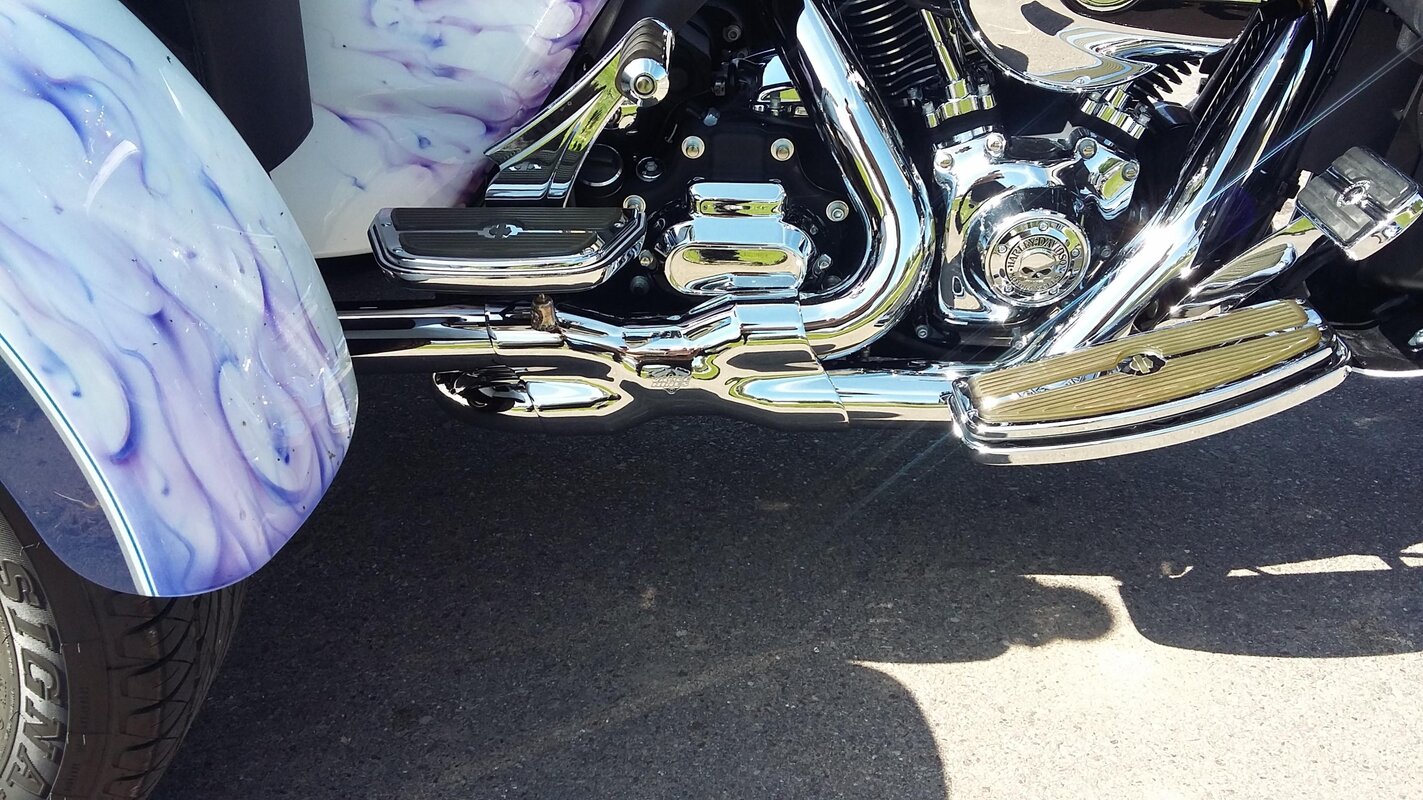

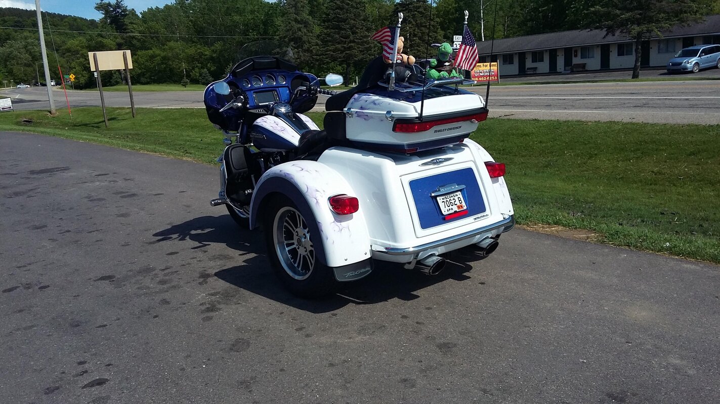

I have the V&H Power Duals and Round Slash Cut mufflers on my 2015 Tri-Glide. I will have to say that this combination is a bit loud, but not so much that you can't hear the radio. I also installed the Screamin' Eagle high flow air cleaner and had the dealer reprogram the EFI. There is a definite improvement in performance.
I also installed the rider floorboard spreaders. This along with the elimination of the cat con has made a significant reduction in the amount of heat felt on my legs.
