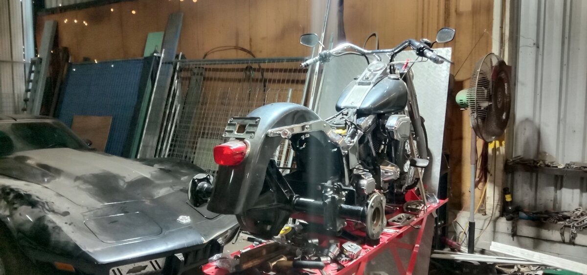

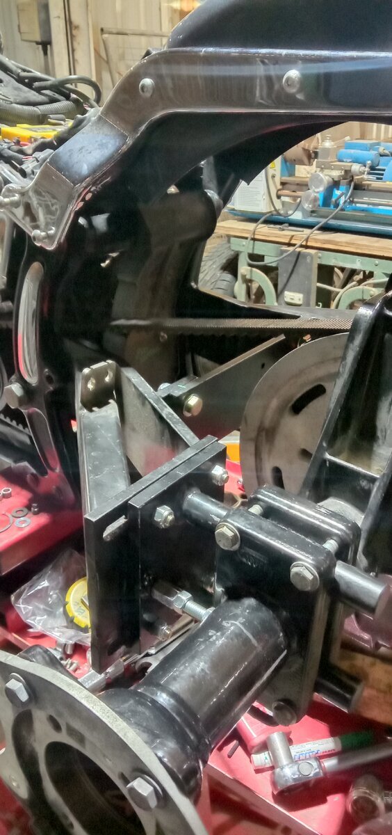

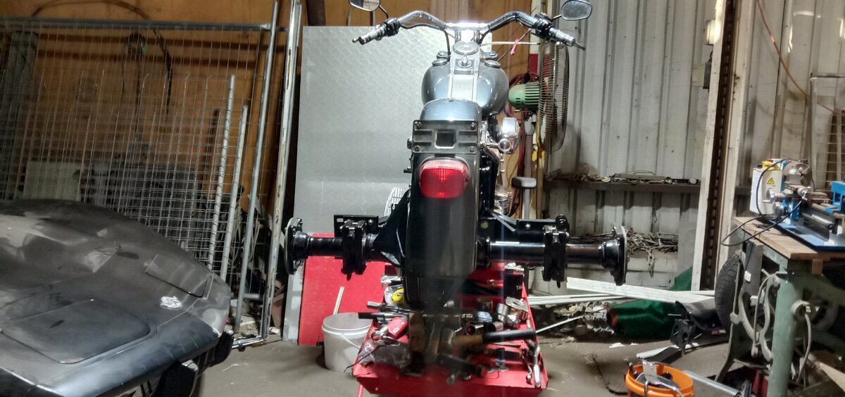

Some updated pics. I fitted the modified softail swingarm, I made the pin/plates to locate the triglide diff. I have replaced the 32 tooth front pulley with a Andrews 29 tooth front pulley.
I sent Papa Zook a message regarding raked trees but didn't get a reply from Here and from cut and shoot.
So I bought a genuine Harley front end
That has adjustable trees. Fingers crossed it should be right.
I will do some research as to how much rake they have.IMG_20250524_163511.jpg
