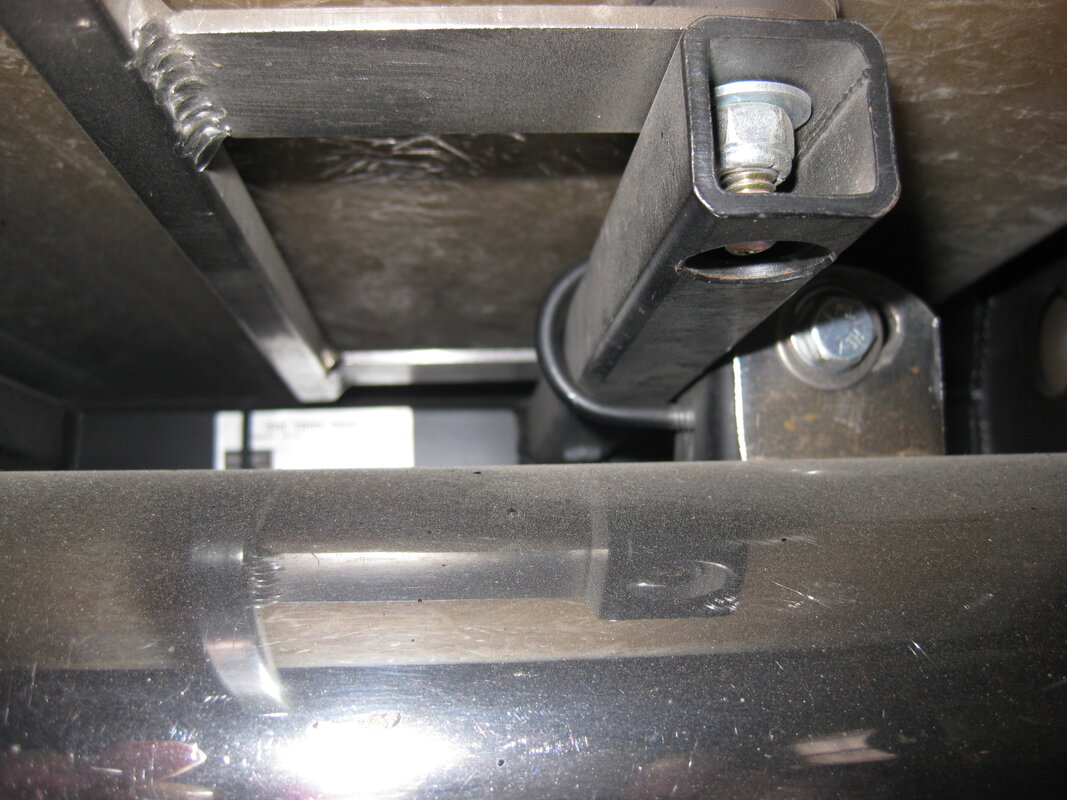

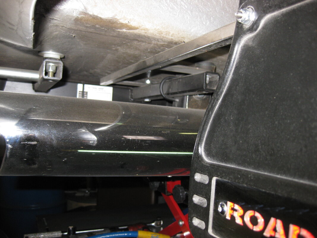

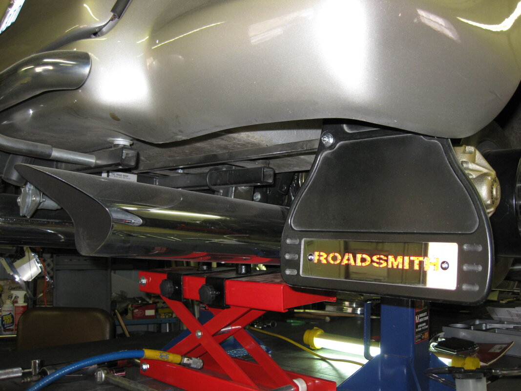

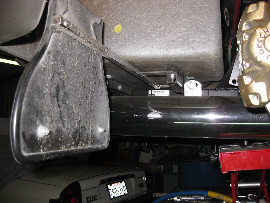

Since I was not able to locate any installation instructions, I was able to find was a photo of the mud flap showing that it was riveted. (not bolted) I will cautiously select the location of the 2 drilled holes. Will use a toothpick size drill bit to determine the space dimension
of the gap between the inner and outer shell. From this I will select a pop rivet that will fit. Will let you know what I discover when I start on the project. Just now starting on installing my diy mudflaps on my Roadsmith.

Mudflaps on a Roadsmith.....

Thanks SolidBob,
I found these same pics last night while reading a post about someone's jack. I will install my homemade flaps almost the same way but without the welded tabs. Going to use box alum., or steel, and mount them to the bottom of the trunk. Will add a strip inside the trunk to help solidify the 4 bolt heads that I plan on using. Gotta love the equipment that this person has for his trike.

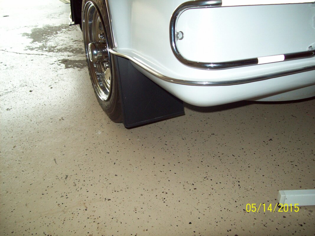

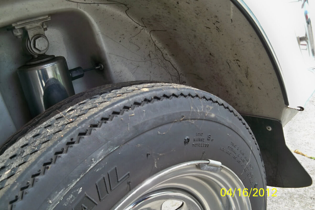

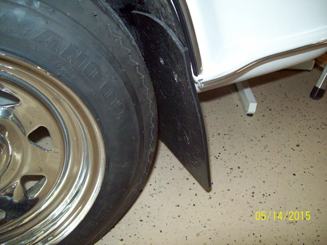

Trailer mud flaps installed. Trailer Left Side Mud Flap.jpgTrailer Left Side Mud Flap 2.jpg

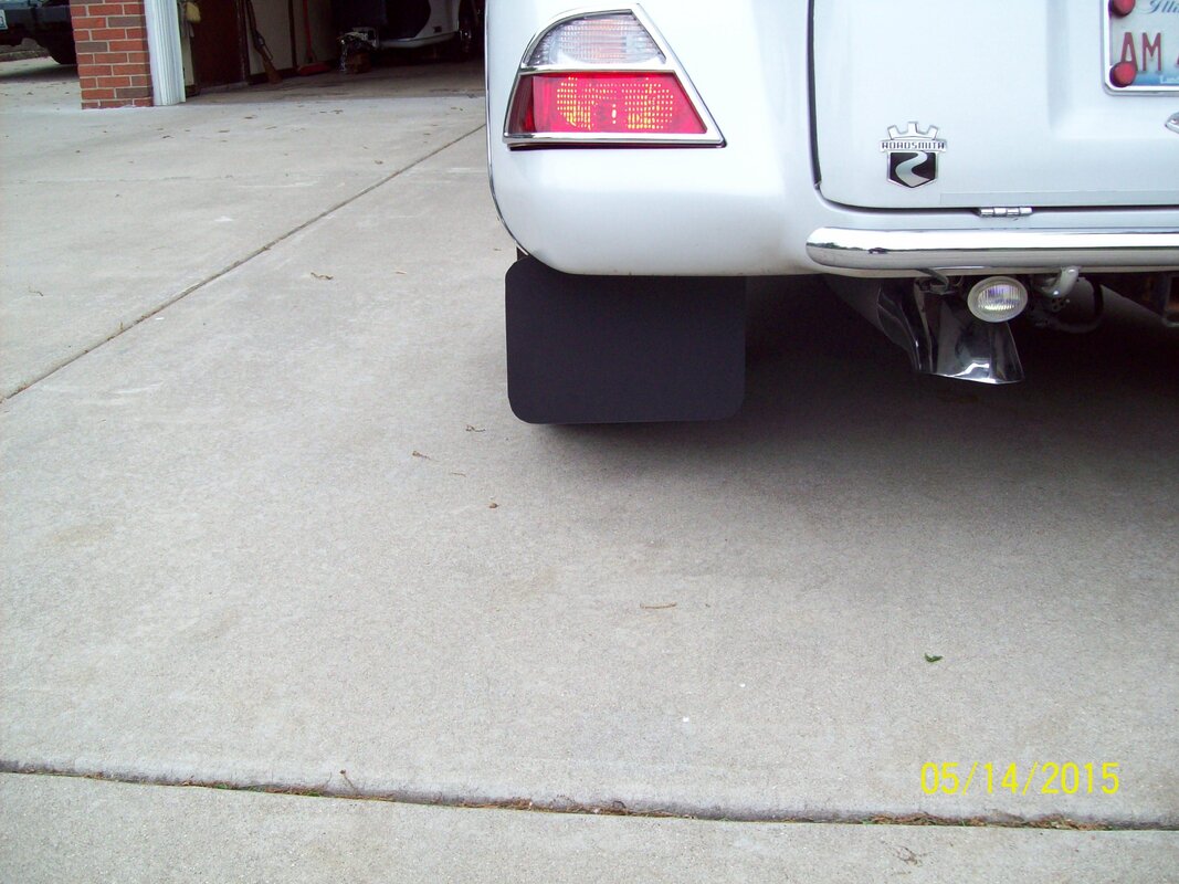

As previously mentioned, I selected two places to drill a very small hole to determine the distance between the inner and outer shells of the trailer compartment. Being very careful not to drill through the inner shell. Drillled two 13/64" holes and used 3/16" x 3/4" rivets. Used 1/4" tractor trailer mud guards/flaps and cut them to fit to my satisfaction. I think that they look great and after 200 miles I find no problem with them.

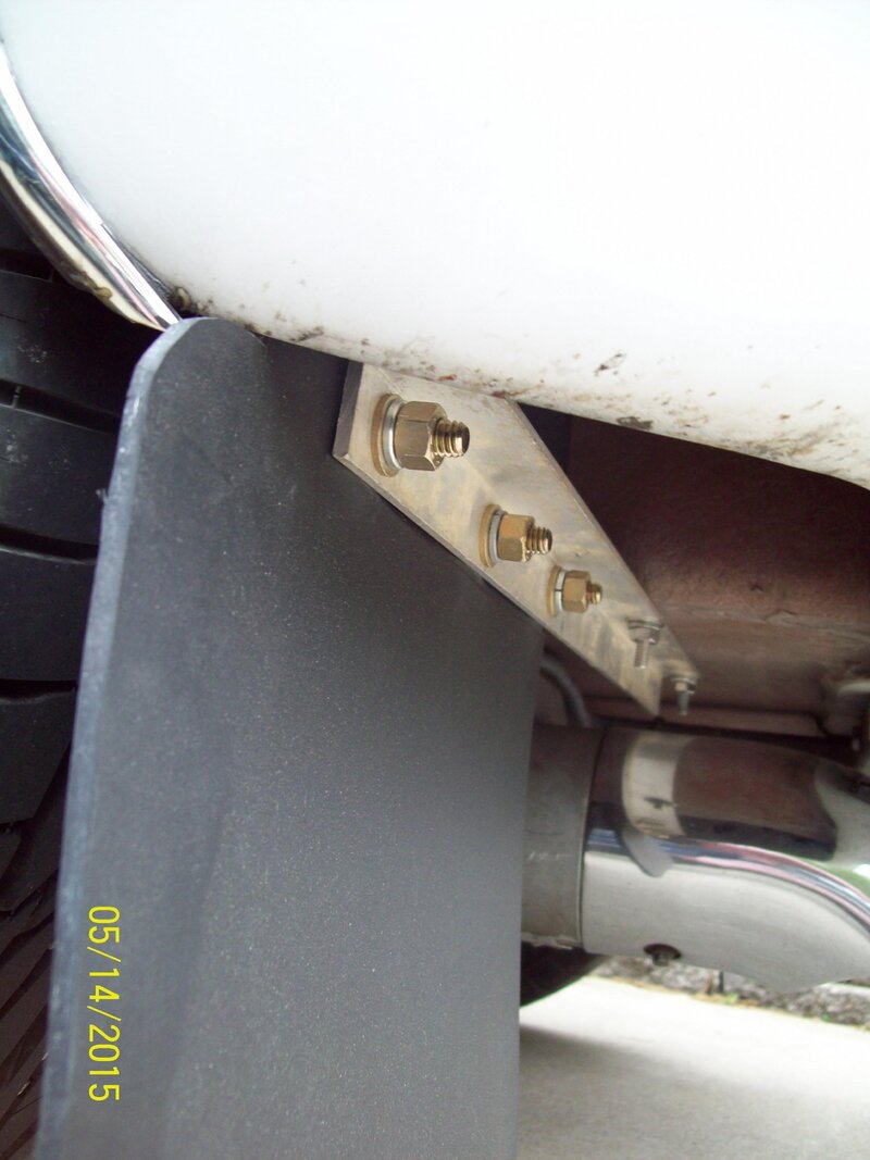

Have also just finished adding flaps to the trike.

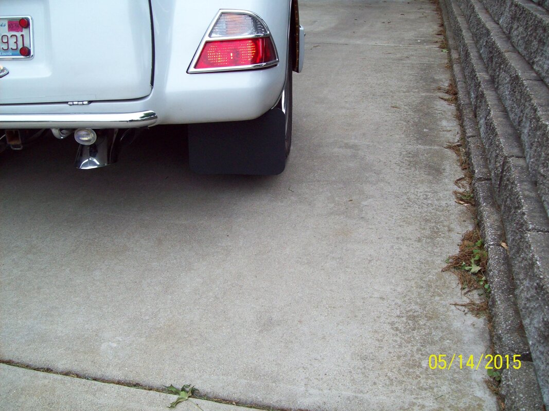

Trike Left Side Mud Flap.jpgTrike Left Side Mud Flap 2.jpgTrike Right Side Mud Flap.jpg
Used al. angle mounted to the bottom of the trunk and added a strip of al. inside the trunk to add additional support. The flaps are made from the same material as those on the trailer. I made them larger to protect the underside of the trike and also the trailer. Also over 200 miles on them and I am very pleased with the results. Might not be a pretty as the OEM's but they shall suit my needs just fine.

Trailer mud flaps installed. View attachment 27328View attachment 27329
View attachment 27325View attachment 27326View attachment 27327
