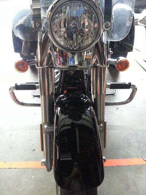

These are the Linby bars that were on my '08 Ultra, '09 Tri-Glide, and now on my 'Free. I took off the crash bars and lower fairings on the previous bikes, don't need the storage space and without them get more wind. The bolt holes for the lower arms are already there, I 'fabricated' a mount for the top bolt and did a little 'tweaking' on the top bracket. The Linby crash bars make good highway pegs.
I like them!
I really like those and the one from Bagger Nation. However,the B/N bar is over $400,too rich for my blood right now.
Steve,can you post a photo of yours,from the side?
Making brackets for crash bars, (Highway Bars for the more sensitive types) a trike is easy. Think outside the box. Remember, the bar will never be used to protect the engine. It's only there to put you feet on. Some scrap steel or aluminium, some paint to match your bike. BOOM, you got foot rests! :pepper::D

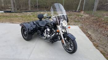

Ok, I got the engine guard off of Ebay ( http://www.ebay.com/itm/331782998692?_trksid=p2060353.m2749.l2648&ssPageName=STRK:MEBIDX:IT ) Turns out it didn't need the bracket for the steering damper. It doesn't even hook to the same place. The top bolt goes into the hole at the top where the two frame tubes come together under the tank. Not a perfect fit, but I "tweeked the bracket a little and it works just fine. I think it came out great, looks and works great as a place to put my feet. The price was deffiniantly right compared to some others. Matter of fact, I saved enough to buy me a new windshield ( http://www.ebay.com/itm/182038097992?_trksid=p2060353.m2749.l2649&ssPageName=STRK:MEBIDX:IT ) It was a great price too and I really like the black tint. I love a bargin. LOL,,,I also bought a luggege rack with light for a great price. ( http://www.ebay.com/itm/252251361181?_trksid=p2060353.m2749.l2649&ssPageName=STRK:MEBIDX:IT ) but haven't got it yet.
