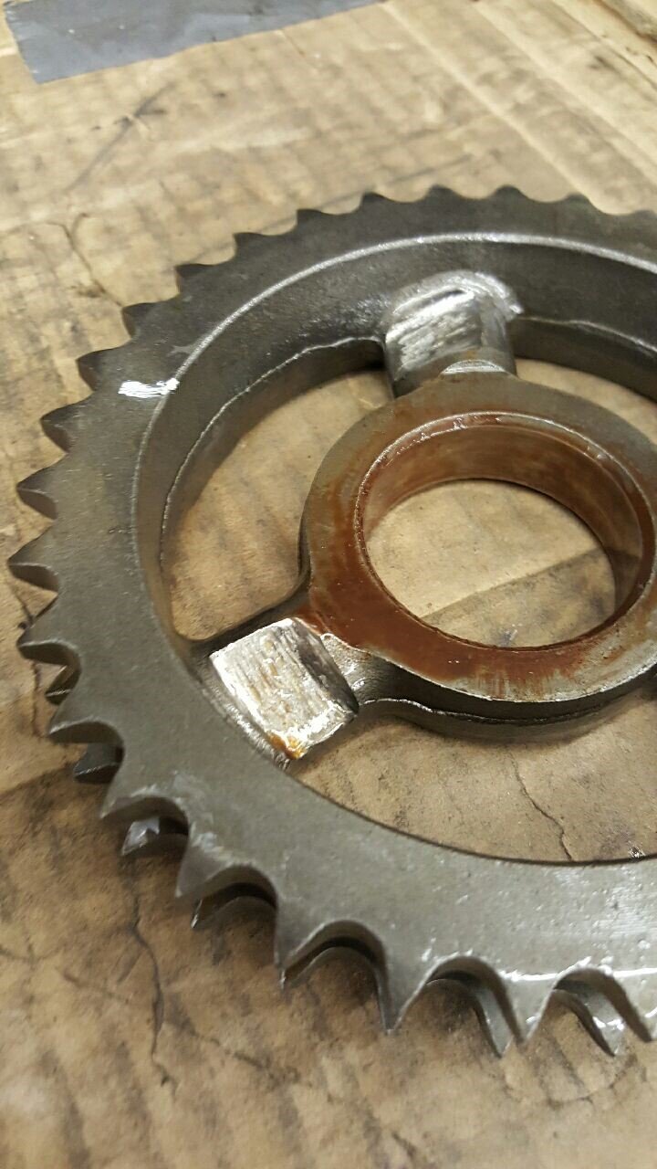

Bike was just in for the compensator, they replaced it, now things are really not right, I can hear a whole lot of noise from it. The dealer will take it back in on August 8th and try to see what is going on.
Here is a picture of the old compensator
About 1/8 of metal missing from each inner piece
This has been a problem on all 6 speed bikes not just Tri Glides. Starter kick back is also a sign of it going bad, Have replaced a few with the 2014 version only to have them fail also.
There is no oil that gets to the critical areas of the comp and if there is its minimal
Like I said Baker suppose to have made one that gets lubricated to the needed areas.
even after I replaced mine to the new revised HD comp it didn't help any and I took it apart after 300 miles and was dry and rusty similar to the pics above. Fretting was evident too. You can see the wear in the pics posted above too on the lobes
