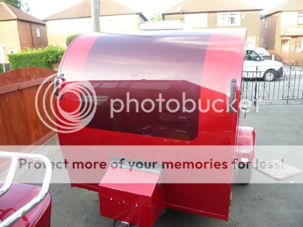

Thankyou bikerbillone; Main reason for having it built was front end grip and handling when towing teardrop trailer.
Total weight was over 3/4 ton.
Now steering and handlings awesome,when traffic allows can ride on cruise control,lightly holding left gripThumbUp
