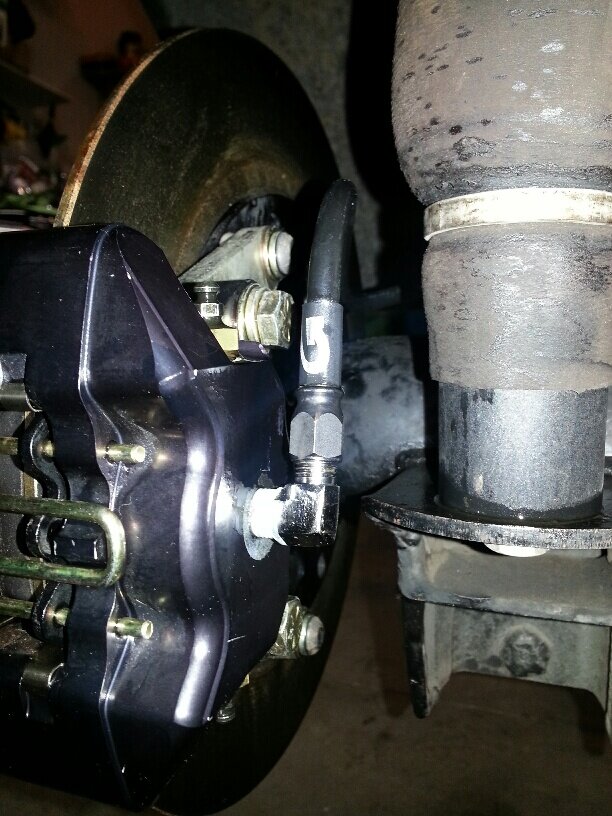

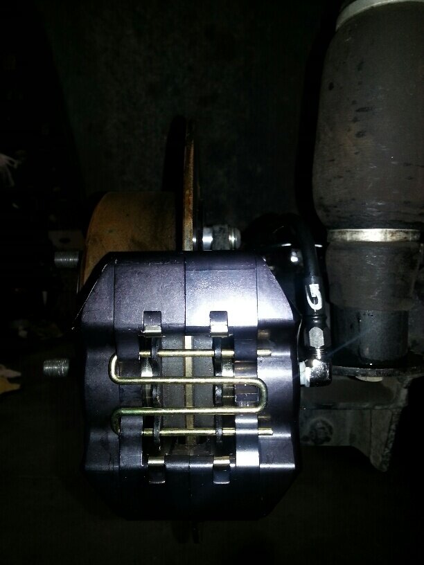

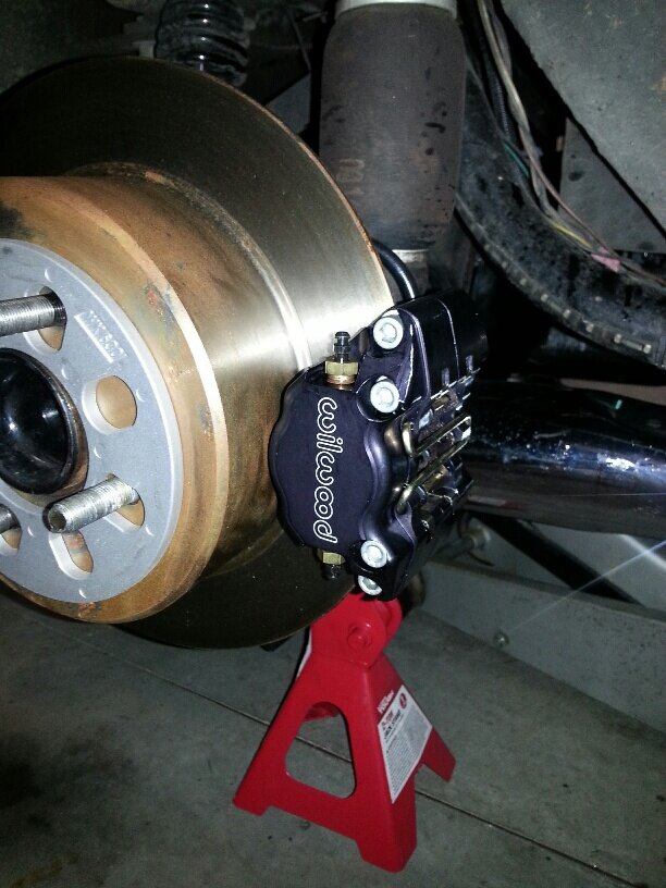

Just completed a drum-to-disc conversion on a Valkyrie with a MotorTrike conversion. Replaced front line and both lines from the tee. Kit is available now.

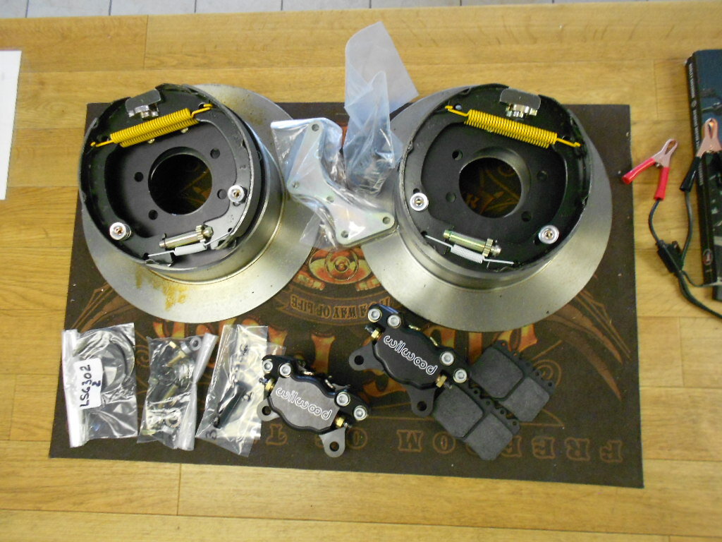

This kit comes with or without an internal drum type parking brake.
