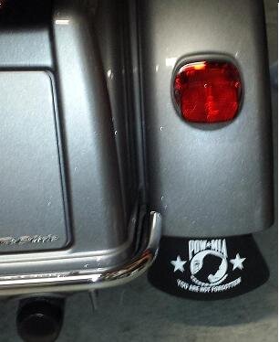

I wanted to put mudflaps on my Tri Glide but didn't want to drill holes in the fenders. After remembering what I used years ago I finally found Gorilla snot ( glue to u guys) I used it years ago and never had a problem. So far these have been on for a month or so and are holding tight. I bought it at Charleston auto parts in Vegas. The behind the counter was an older guy and he knew what Gorilla snot was. Smear some one each part when tacky stick together and hold for a short time or stuff something between tire and mudflap to hold in place. I let mine set for a couple of hours. I think its a nice clean look. Mud flaps are 8" high x 10 1/2 wide.
See pictures

I had this on a trailer for four years back when I pulled one with the wing. Sold the trailer flaps still glued on. Thanks for the reply. I 'll let u know if I have one come off.
I pretty much did the same thing about 3 years ago for the same reason. Did not want to drill holes in the fenders, but wanted mud flaps. Bought the H-D ones, stuck them on and they haven't budged at all. They have been through heat +100°, cold 14°, rain and snow and nothing seems to affect them so far. The only thing I did differently was put a bead of caulk around the edges of the tape to keep moisture out as much as possible.
Guess I should add these are rubber
Glue is the only thing holding them on.
