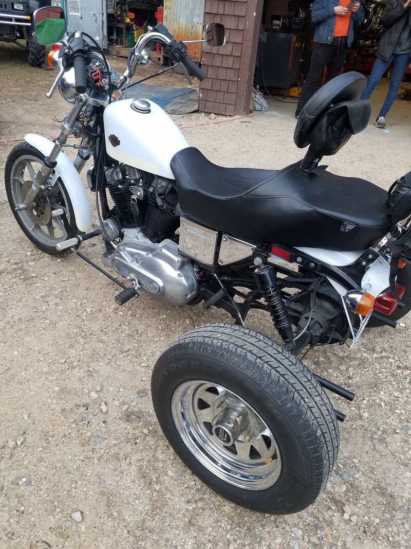

1983 sportster trike rake
I got a 1983sportster trike with servi-car axle and I purchasedan ajustable triple tree from ebay from italy that can be adjusted from -0to 10 degree rake, i currently have a 4 degree rake and it runs nice.sportsterjob3.jpg
