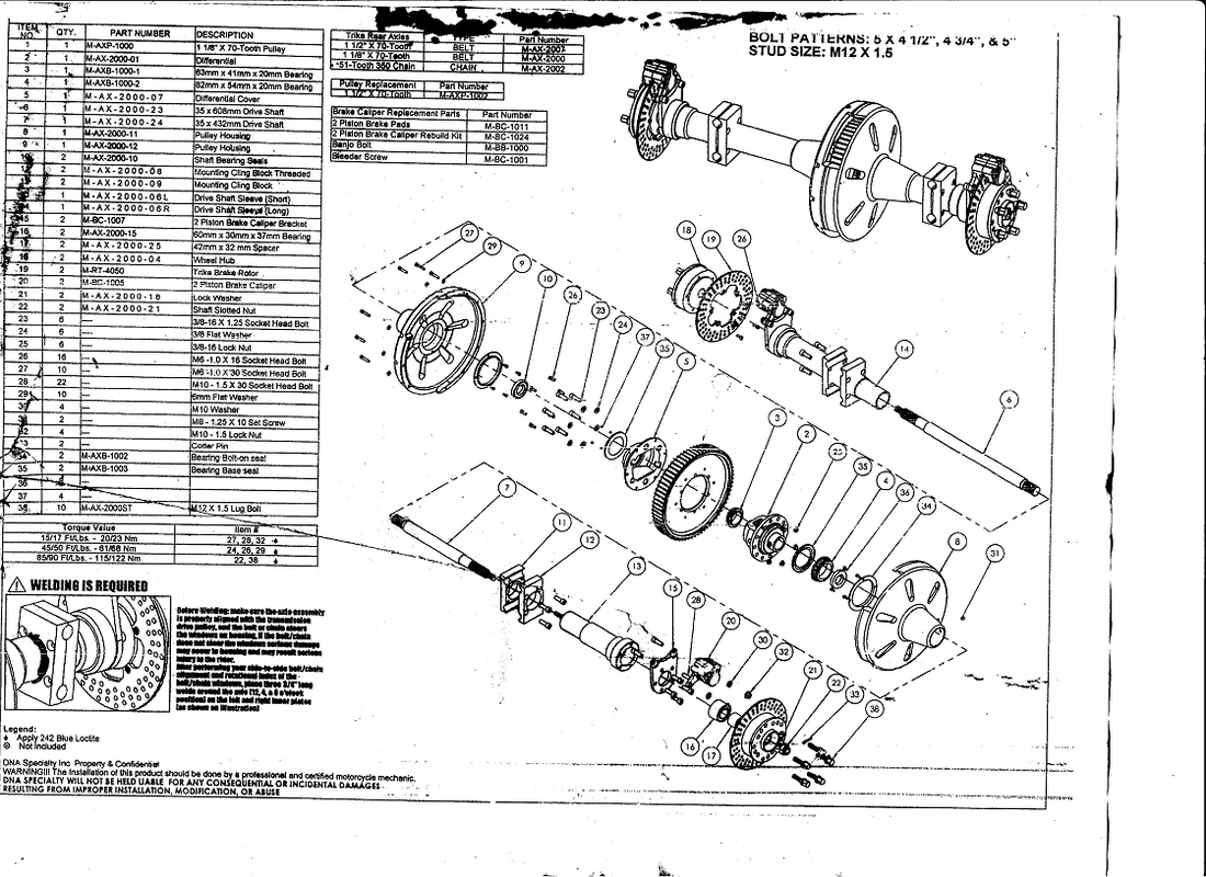

I am currently converting a 2013 sportster into a trike, I have a DNA axle for it but during shipment its shipping frame broke, the axle is fine but the damned thing landed on the diagram that came with it. The diagram is destroyed and DNA is not responding to my e-mails and I can't find the diagram on the internet anywhere. So if anyone has the diagram please post it or send it to me .

I have seen several discussions related to using a DNA rear axle.
I saw posted this part number being discused
napa 641-3132
when I pull this part number it comes back as M12-1.5 Wheel Bolt - 17mm Hex, 29.5mm Length
So my question is, does the axle use bolts for the wheels or studs?

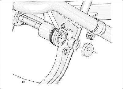

If the stock bushings don't fit, you might not have gotten the correct swingarm.
2001 and earlier used a different bushing, while the 2002 and later used a spherical bearing instead.
A note of caution when using the later swingarm (2002 and later) for a trike, get a swingarm stabilizer kit so that stress on the transmission case won't be a problem in the future.
