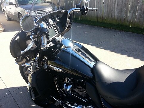

On my 2016 and now my 2018 I have the 1 1/4 wild one 12.5 bars and they really feel good to me, by the way I'm only 5'9". As most on here go with the Khrome werks 2+2 bars either wide or narrow, each to their own, but me I have had tall bars on all my bikes.
All for now TrampasView attachment 98174
Those look great sure look comfortable Congratulations. Ride safe Fred
Thanks Fearless, for me they are comfortable, but as I said I have had tall bars on all bikes, some only 10 inch but never over 12.5 and it depends on the bike.2018--18.jpg This is a better view of bars and as I said in other post I'm only 5'9" and the bars are even with my shoulder and it is a stock seat also.
All for now Trampas
