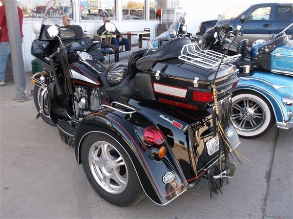

something I noticed on my 80" motors!
I will get some argument for it but my motors ran quieter with Harley oil in them than other brands I used the standard 20-50 weight in it, over 95,000 miles and engine was running just fine I had developed leaks under the cylinder head ( as the evo is prone to do) never had any problem otherwise. I would think it would have gone another 20-30,000 otherwise but no sense in doing a top end without doing the bottom at that point. Truth is your going to hear some noise in the old evo's unless it sounds really evil it may be natural? Stock engine is a single cam and all I ever did to my engine was to put an E-27 (mild) cam in it just to get a little more umgh out of it.
I am of the school that the more you do to an engine the more you will have to do to make it run right, The evo is damn near bullet proof if you do it right. I added an oil cooler right off the bat even though it was said the evo didn't need one, It sure never seemed to hurt it and as I said im old school where we were rebuilding at about 50,000 mi. on our old scoots. I have had my old tour glide for 27 years and really have no need for a new one.
When Harley designed the 80" evo it was promoted as being tough and long running, It was never promoted as a speedster. Mine pulls my trike down the road 90 mph and that's plenty enough to kill me. The 5 speed tranny works great for me in Wyoming where I seldom wish for a higher gear due to terrain.
If I am two up and pulling my small trailer out here where the damn wind speed usually exceeds the ambient temperature I have wished I had a little more power every now again since I converted it but not often. People out here often judge the 103 tri-glide as underpowered when it seems to me that running it in 5th gear instead of sixth would take care of the problem? (lugging) The tri-glide in the pic beside mine has a thundermax kit in and damn sure runs good! I just don't really one.
