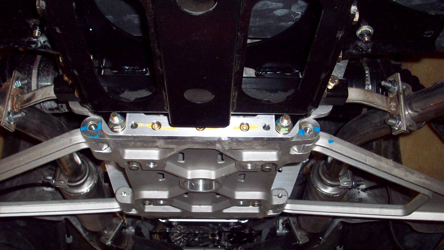

I have a 2013 CSC Cobra XL Trike Kit on my 2009 GW, I have a Trailer that I bought at Harbor Freight (the one that comes with the luggage tote mounted to it). I filled it with flats of water and Gator Aid which I pulled it from Lawton OK to Moore OK (approx. 115 miles) in the aftermath of the Moore Tornado. I filled that trailer till no more would fit. I then filled my trunk and top box with as many dried goods as I could and my daughter and I took the stuff to Moore. My Trike and trailer did outstanding, my gas mileage did suffer a bit, but the trailer pulled just fine without any issue. I to have the Chrome Flat Steel (approx. 1/2 in thick and 2 inches wide), it is the same as a class 1 receiver that Reese Hitch and U-Haul sells and it's been working for them.ThumbUp
