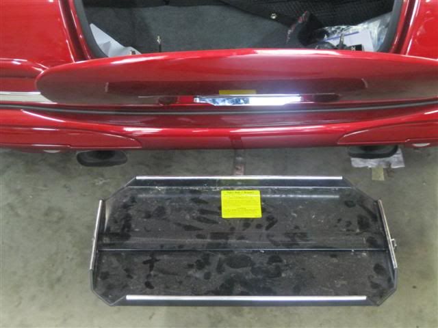

This is the only photo I have. Does yours open this much or more?
My 2006 trunk lid opens untill it is parallel to the ground. I don't like the way they stick into the cargo area. I am looking into designing some covers for them so when I load the trunk it will prevent me from putting items that interfere with them. Will also prevent items from shifting and causing them to be obstructed when trying to open them. From your pic my lid would open it looks like untill it almost laid on your rack.

your hinges are different. Mine has slots in the center for the rollers to roll on. I wouldn't want it to drop down that much. However, a good machine shop could make some hinges some longer allowing the lid to drop farther down. that really wouldn't be that hard to do.
I couldn't see your hinges in your pic. Mine are 1 piece and no rollers. It is convenient that it opens that far. Otherwise I could never get my helmet in. But they extend into the trunk quite a ways. That I do not like!!
