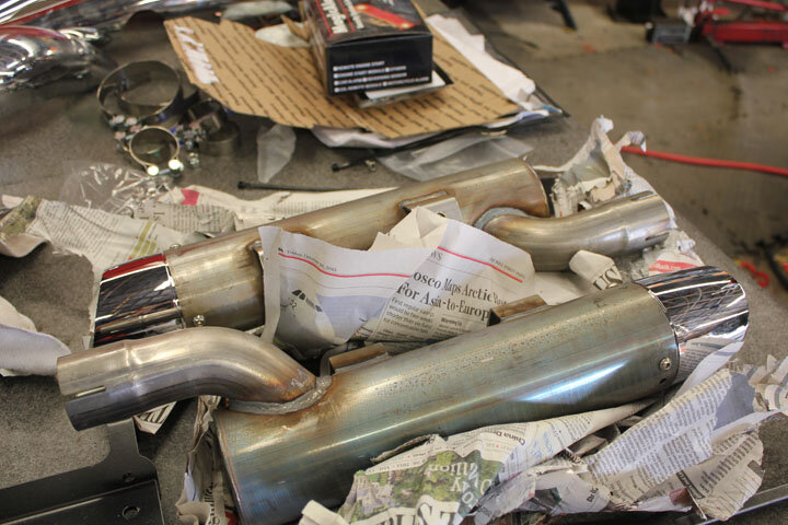

i had csc send me muffler pics. they make their own w/supertrapp componenents...their exhaust runs through the suspension. roadsmith goes underneath.you can use stock mufflers or anything else.. you can add or subtract discs from csc mufflers to change the exhaust note.
Do you still have the pix from CSC? If so would you share them with us? Thank you.
Yes, that is correct. CSC puts 12 discs as you stated earlier into their mufflers. That is the recommended number of discs for larger displacement motorcycle engines but can be added/subtracted to change exhaust note. It will also change the overall performance of the motorcycle.

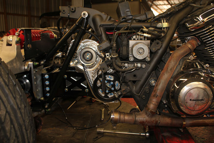

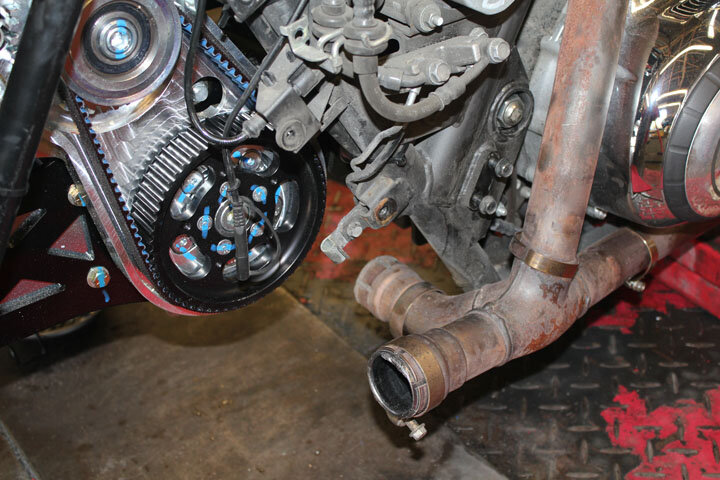

great pics on your install.. the only thing i havent seen on any pic anywhere is the sway bar maybe i dont know what i m looking at.
I wasn't there for the kit attachment to the frame and I'm not sure I could have gotten a clear shot that what you're looking for. These 2 are as close as I have.
I took several more but only posted what I thought might show the salient points. If you are looking for something else just ask, I may have it.
Sway bar
Because I was in the shop today with the camera, I took some more shots trying to get something more meaningful of the sway bar. Sorry to say they didn't show anything meaningful.
