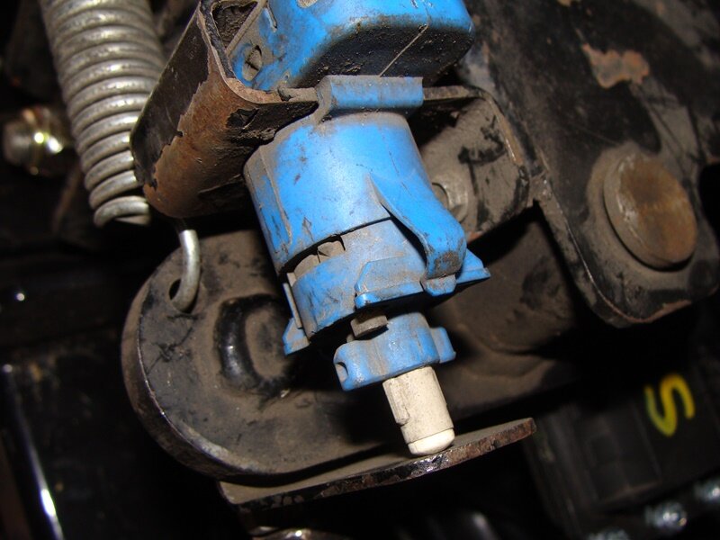

Hi. With about 6000 miles on my Stallion, my cruise control simply quit. Fuse fine. Brake lights not on. No indicator on instrument panel.
Any troubleshooting tips please?

Mike,
No trouble shooting tips ... but mine failed and had to have it replaced, thru TMS.
Mine quit a few years ago. Under the bike on the brake linkage, there is a tab which contacts a switch. A slight bend of the tab corrected the problem.
Thank you so much for the tip. I am still over a thousand miles from home. I assume the brake linkage is a rod which runs to the back of the bike. Is the switch blue and white?

Mike, here a pic of the cruise control unit. That was the first thing I checked, but unfortunately the unit had to be replaced. Good Luck.
That little black switch also works the brake light !! I replaced mine 4 times before I just took it apart and bent the contacts so they would move when the plunger is pushed. I think that most of our first problems were more of a quality control issue on the contacts. No more problem in the last 45k miles.

ive had the same problem with my 2010 model.....and it turned out to be a bad secondary brake switch....
I bent the tab and now it works! However, when I hit a bump it cuts off. Did I bend it too much or should I back it off a bit please?
About a month ago, it quit working and now the cruise control icon stays lit in the instrument cluster! Even when I press OFF the icon stays on!
what do I do now please?
