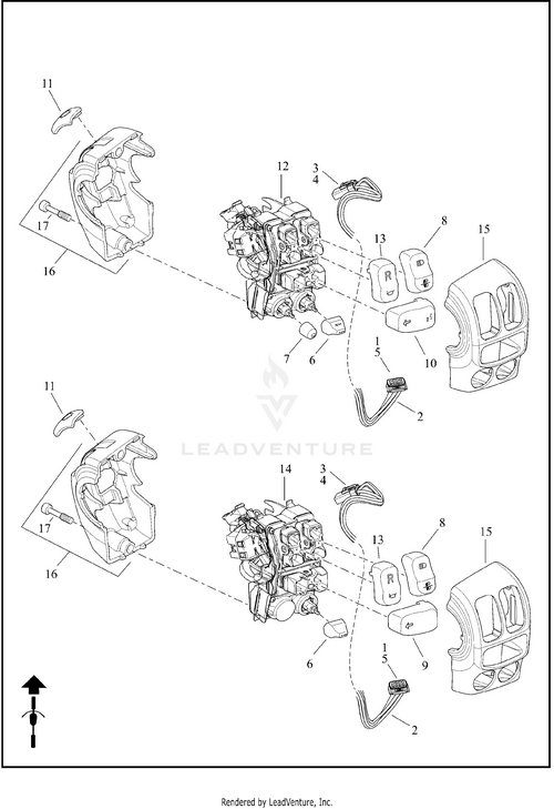

I was riding in a charity run last week. A lot of it was on interstate hiway so I was using the cruise control quite a bit. I got to the last stop and noticed that the plastic switch cover was gone off of the cruise control switch. The switch & cruise control both still function it's just that the plastic cover with function indications is not there.
Have any of you had this happen to you? If it has is the plastic switch cover available at the dealer. I really don't want to have to perform surgery on the left hand control set to fix this.

Is it # 6 in the diagram?
Ref:
6
71500044
3-WAY KEY CAP,CRUISE
[FONT=&quot]Price: $12.31[/FONT]
[FONT=&quot][/FONT]
Push to talk and cruise switch are identical. When I had my 2014, I have the dealer flash my bike to reverse the PTT and cruise switch.
I wanted to be careful when pulling them off - so, just in case, I purchased an extra switch - number is 71500225.
If you need or want this, send me a PM and I will get it to you.
