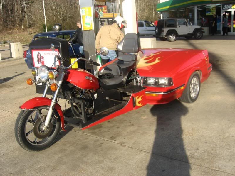

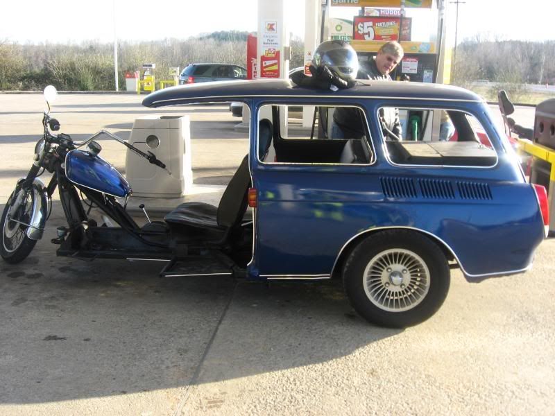

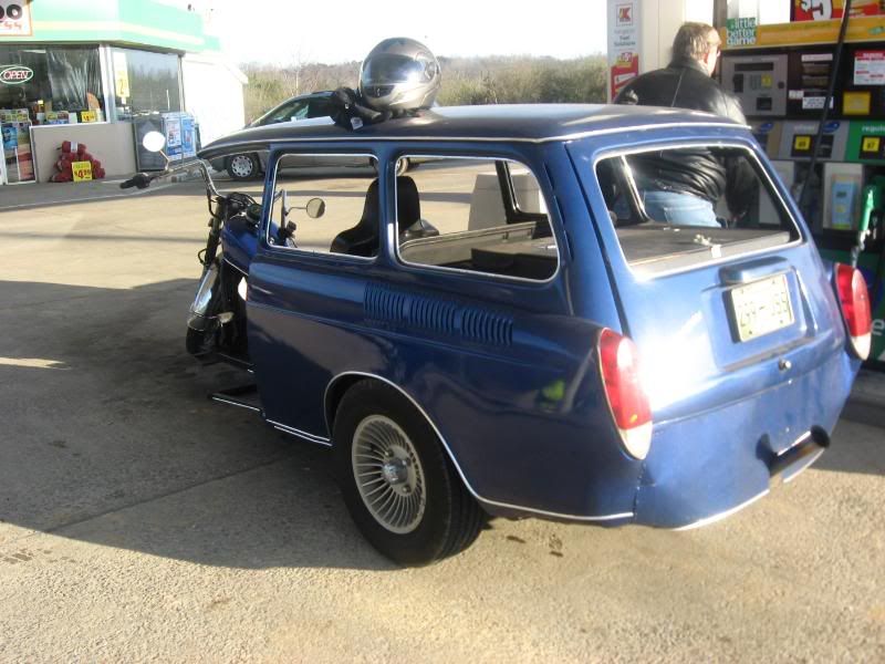

I photographed both of these Trikes at the BP/Subway Store in Bakewell, Tennessee out on Hwy 27....."DIFFERENT".....
This one is VW powered.......

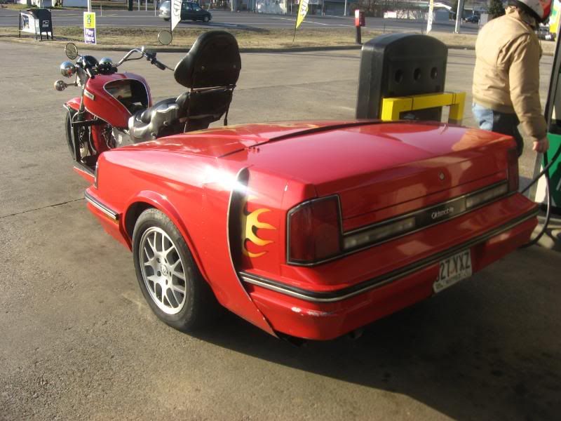

This one is VERY unusual. It uses a FWD Cutlass Cierra with the frontend moved to the rear and the rearend narrowed and inserted into it, spindles welded/steering removed, 3800 V6/Automatic...."unique" for sure.....
....both were Locals to the Area.....:wtg:
Both were pretty neat....the VW owner carries His Wife and Kid in the back seat....VW had an aftermarket plastic fuel cell, and the Oldsmobile still retained the original gas tank with the electric fuel pump.....:cool:
