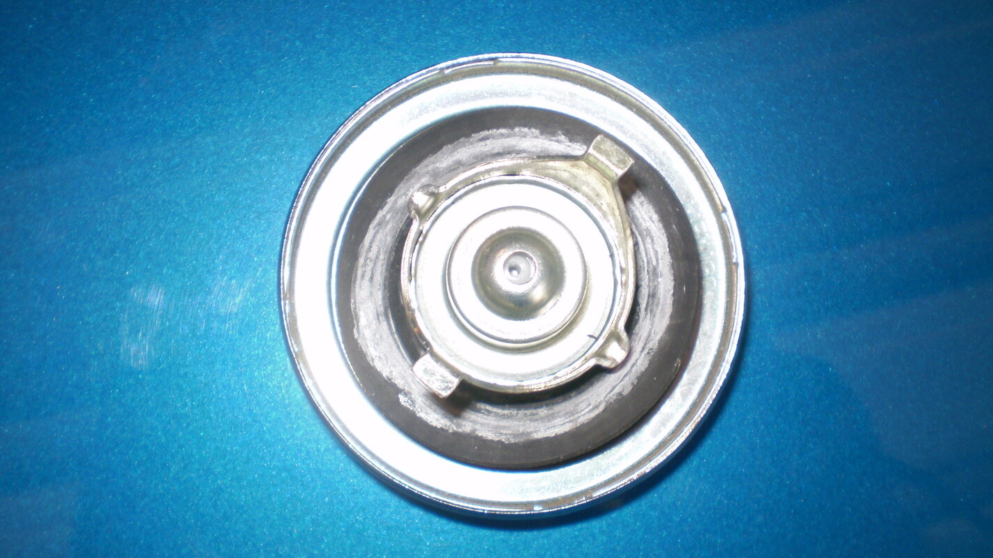

It will need a "vented" cap. I would honestly check the gas cap and make sure it is vented or if a vented cap, make sure the little vent hole isn't plugged.

However, I would start simple first. Lets check that the gas cap is actually venting. That will also cause these issues.
Gas cap off, still came to a the same results.
