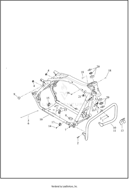

In this picture of the newer Trike frames I would drill and tap dead center between the top and bottom of the neck
