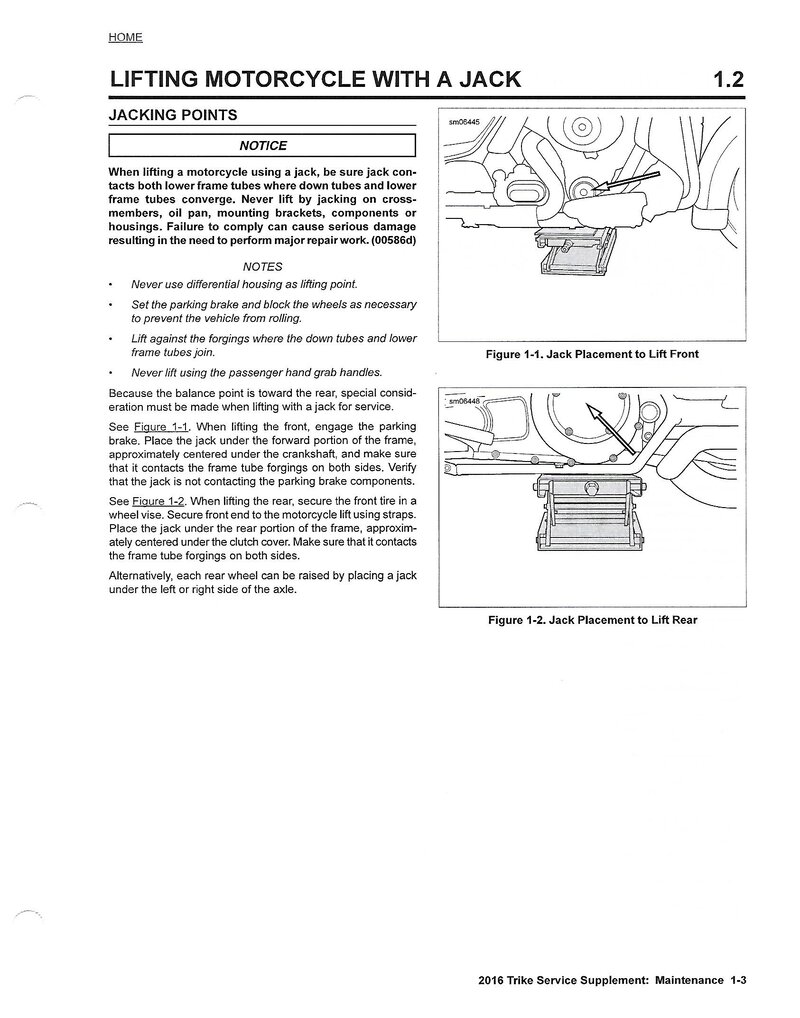

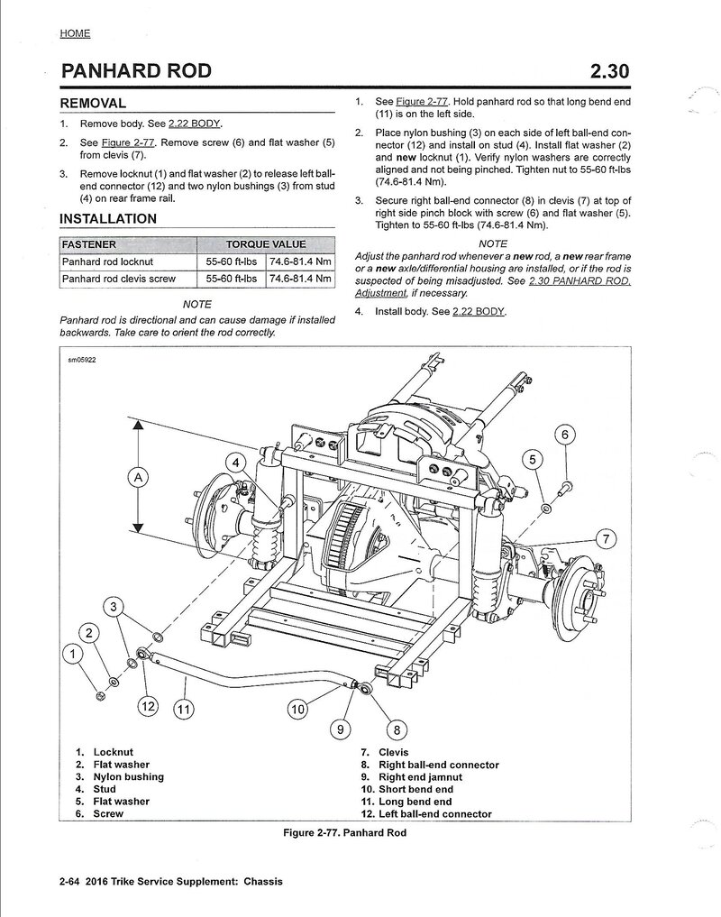

In case you haven't gotten copies yet, here are two different pages from my 2016 Trike Supplement Manual.
Jacking Points Page
The page below is included just to show you the chassis without the body. You can better see jacking/lifting points and also the forward crossmember under trunk to place Jack Stands after it's raised.

Thanks to all who replied to my noobie question! I feel confident now that I'll not have any problem installing the kit. Special shout-out to ShapeShifter for including the diagrams from the Trike Supplement!
