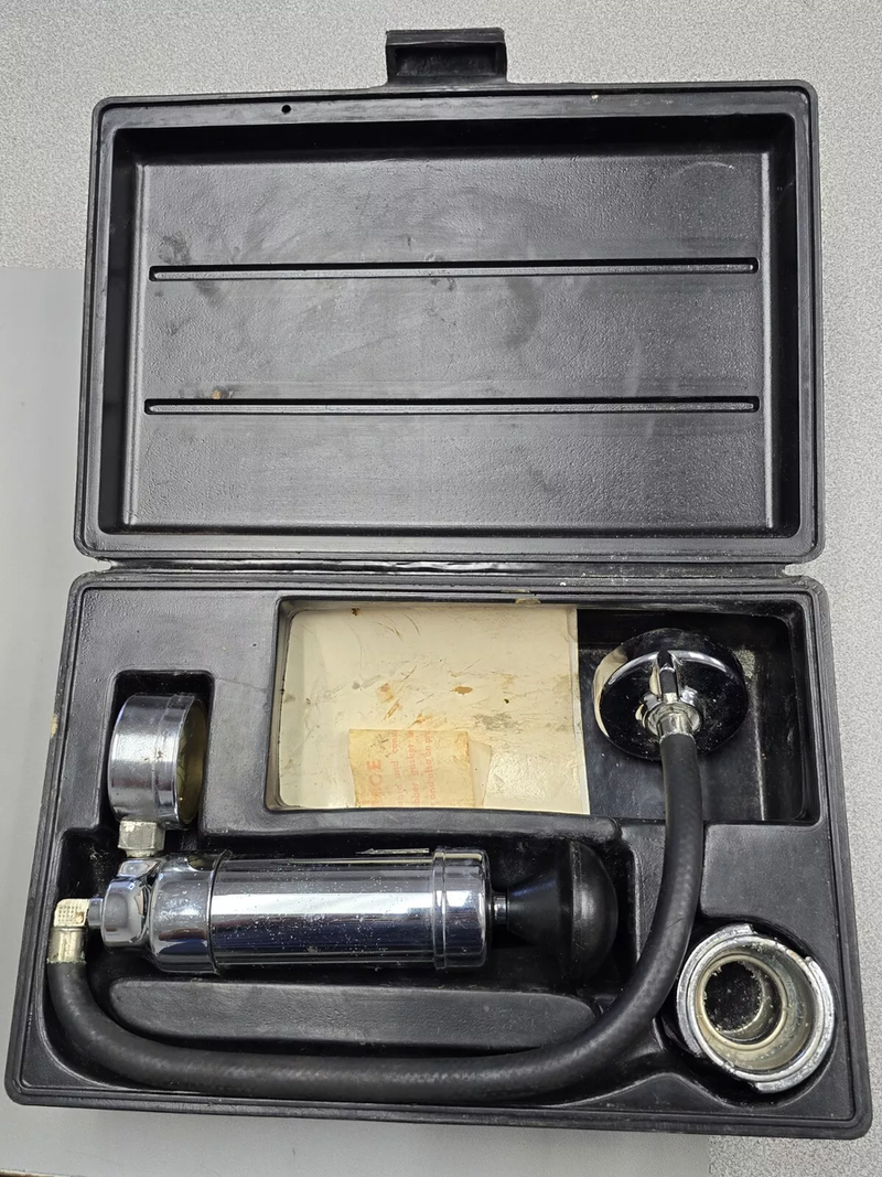

You could take the radiator cap to Orielys and have them pressure test it with a Stant radiator and cap tester like mine
Thanks Kevin, Jack. I'll see if I can get the cap tested. Maybe at NAPA as I haven't seen an O'Reilies around here.
The filler neck that the rad cap fits into seems to rotate relatively easily in the rad hose / clamp arrangement, but I'll see about the cap first.
