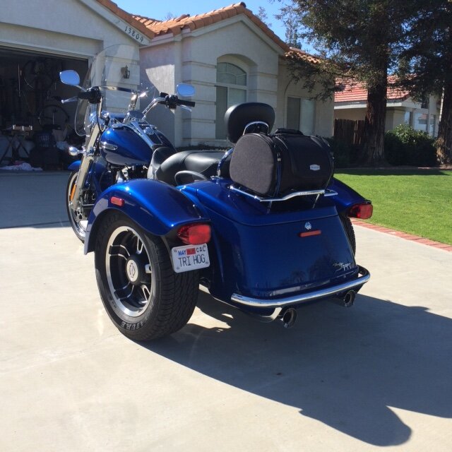

The Cobra slip on freewheelers mufflers are very nice indeed and I looked at them real hard, they also sound very nice.. I went with the D&D 3 1/2" Touring mufflers with the 2" diameter vortex baffles instead and I like them a lot.
The only reason I chose the D&D mufflers over the Cobra mufflers was the baffles in the Cobra slip ons where 2 1/2" in diameter. I have found more often than not over the years when you go to a bigger baffle than a 2" diameter in the mufflers on a stock Harley motor you tend to loose a little bit of low end torque. I just did not want to take the chance that the Cobra mufflers larger baffles would affect the trikes low end torque.
Manufactures today because of the catalytic converters are going to bigger baffles to get the sound out of the mufflers. I think for the most part this is because of the muffling affect of the catalytic converters. It's a well known fact when the cat is removed the exaust system gets louder.
