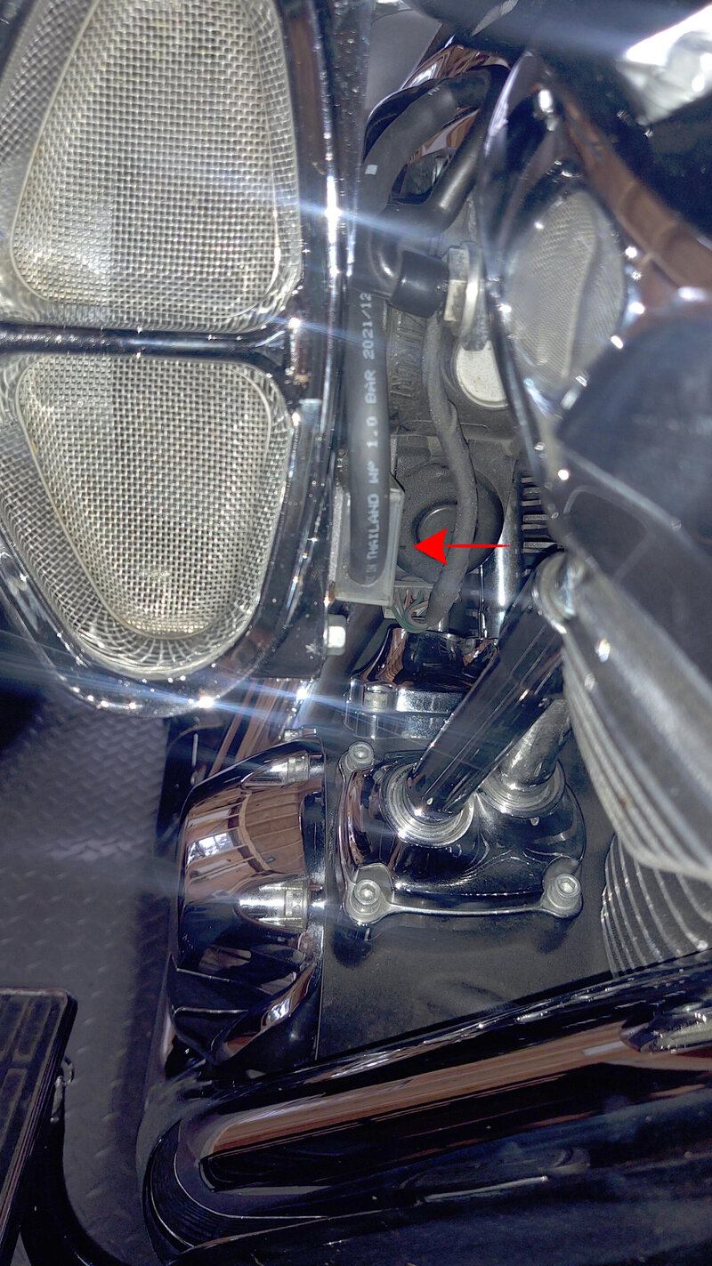

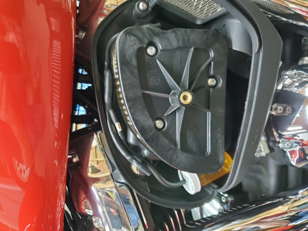

I kept the crankcase breather hose in the factory position. Went to the 5000 mile service that way. At around 6000 miles I was curious if they had “cleaned” my K&N Air Filter and took the cover off. It was practically spotless inside. OK. Since then I would occasionally see an oily film on the back of my air cleaner cover. I’d wipe it off and go about my business. This afternoon I decided to take the entire air cleaner unit apart. I’m at 9000 miles so let’s see. I left the two pics in question full size for examination.
On the vent hose you can clearly see a large drip of oil & moisture content. It hung there ‘till I wiped it off. Below the hose you can see where the oil is dripping on the intake, running down past the screw and dripping from the bottom of the mounting plate into the rubber bottom seal of the K&N filter. There is little or no oil in the filter pleats themselves. Lastly, you’ll see the drip line and collection of oil inside the bottom of the cover. This explaining the eventual film on the outside bottom and rear of the cover that I’ve been wiping off. Here’s the kicker. The inside walls of the intake and the butterfly had almost NO residue on them. Now I know a throttle intake isn’t a Kirby vacuum cleaner suction, but the lack of excessive residue seems to me like this particular Cobra PowerFlo Intake is acting like a rather large catch can? Maybe? Thoughts?

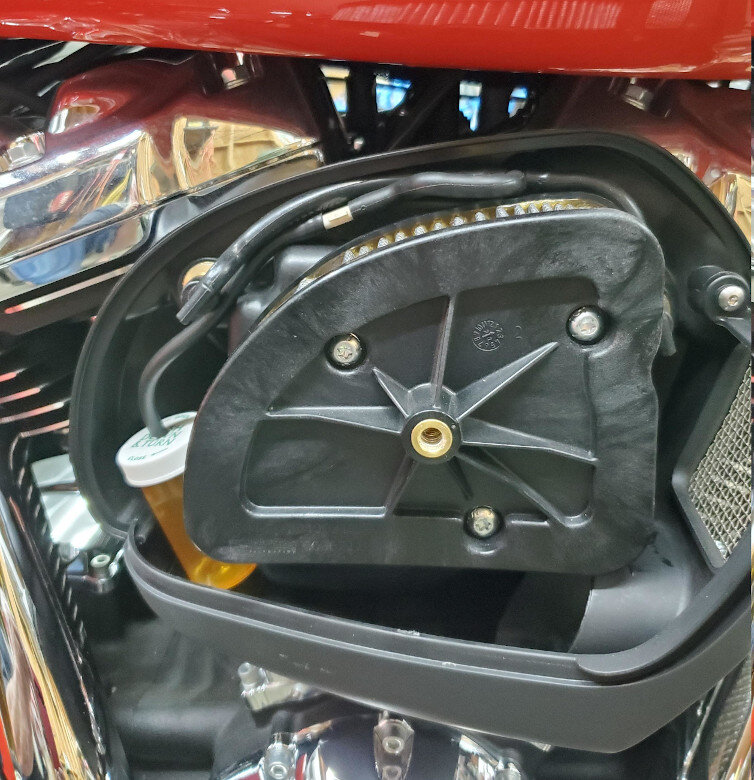

So since I'm back from my 10,000 mile service I've revisited the breather catch can situation and I just don't like anything on the market. I don't want a fancy chrome something to show off, and while Jack Klarich's great idea of the pill bottle in the back of the air cleaner body may work well with the stock air cleaner, I'm running a rather smaller Cobra air cleaner and there's just no room for a pill bottle in there.
What I've been experimenting with is a 1 1/2" long by 1" wide and 1/2" thick flat, rectangular polypropylene box with a hinged lid that snaps shuts. (I had one in my parts closet for some reason. Go figure.) Pulled the OEM hose out of the backing plate of the Cobra air cleaner and capped it off from the back. Replaced it with a hose that runs into the back of the polypropylene box and drilled another hole for pressure release. Put the box on inside bottom of the air cleaner. It couldn't move or open and is out of the way. Ran it like that for 600 miles. Worked fine. BUT, I had the thought that it may be interfering with the air flow despite how small and low profile it is.
Today I pulled it out and mounted it outside of the air filter on the backing plate facing the motor. Used high strength exterior grade Velcro. This keeps the air flow into the throttle body clear and keeps the blow by oil from going into the engine. My only concern is the polypropylene box I'm using holding up to the heat of the engine which is a mere 5" away from it. I posted a pic of the trike with Cobra air cleaner for reference and a pic of the mounted polypropylene box. (Red arrow) I've since found and ordered a round tin box about the same size with a screw off lid. Let you know in a next week or so how that works out.

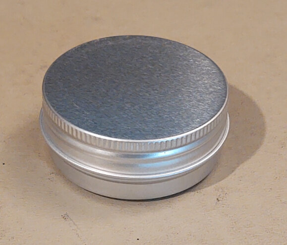

Got my tin cans in and used the 1 oz can.
I feel better about having the metal there other than the plastic even if the plastic seems to be working fine. Now I can just unscrew the lid, wipe out the inside and screw the lid back on. It's also bigger than the plastic box, but fits in the same place just fine. It really seems like the engine "feels" better without any oil mist in the mix. The cans come in a ten pack for about $8 so I can afford to experiment if need be.
