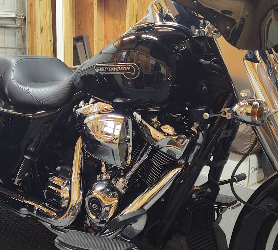

Welllll, I did put this Cobra Aircleaner with K&N filter on several months ago.

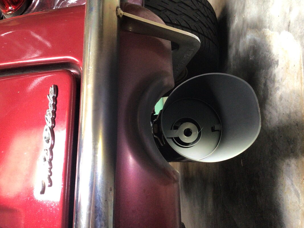

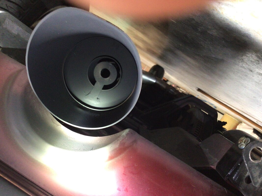

I have Fuelmoto Jackpots with a welded lollipop for back pressure… they sound great. They were a bit loud and had a droning sound to me. I simply welded a heavy duty 2” washer with a little tab to the end of my baffle and coils, Torque added, sound is A bit mellowed, perfect for touring. If I want it louder I could just bend it out. I tried a few angles and like this was the best for me.
