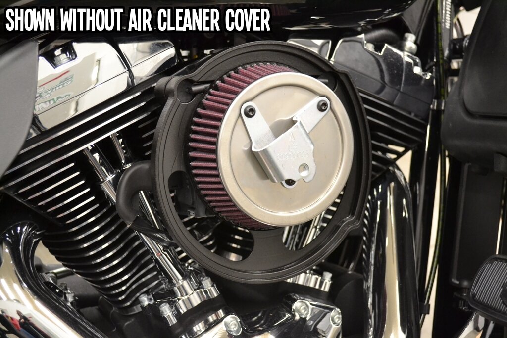

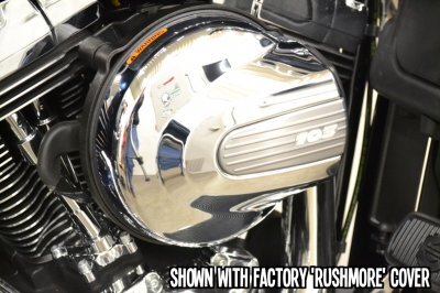

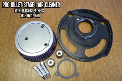

This Stage 1 kit from Jamie at Fuel Moto allows me to use my stock My Rushmore design A/C cover. The S&S stage 1 kit that I was going to get and posted in another thread did not allow the newer Mt Rushmore style cover to be used.
I like the Factory snorkel cover on the 2014 and newer Harley touring bikes. It works more like a cold air intake in my opinion and I really like that about it. ThumbUp
Also this Stage 1 set up will cost me a little less. It never hurts to accomplish the same thing and not spend as much doing it :pepper:

I was not able to get it to link for some reason. Just go to www.fuelmoto.com then select the parts for Harley tab. Then just put in the year and model and hit search. Then scroll down until you get to the Pro Billet Air Cleaner for the 2014 & 2015 models about halfway down the page.

I am using the the ac you spoke about. It was the easiest ac i ever did. Took 20 minute to do. It will sure breathe now. I like the new sound with the catless header. Sound is subjective but I like the sound. Almost perfect for me.

As the air passes through the snorkel in the factory air cleaner cover going down the road, it would naturally be forced out the backing plate holes on this kit towards the cylinders. I wonder if this would add some minimal cooling to the cylinders when going down the road??

A k&n filter may be all one needs with the new rushmore ac. I got it at a low cost, it comes with a filter that is close as the k&n filter. You clean it and oil it the same way. It is cotton like the K&N is.
The backing plate is much more open and allows much more air in. It looks like the factory breather.

Looking at the backing plate on the Rushmore a/c makes me wonder why one couldn't drill some strategically placed holes in it,for more air flow.
