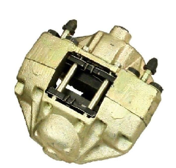

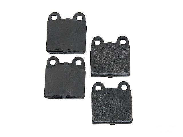

Late 60's Karmann Ghia or Squareback
http://mjtrikes.com/shop/index.php?main_page=product_info&cPath=89_92&products_id=318
http://mjtrikes.com/shop/index.php?main_page=product_info&cPath=89_90&products_id=321
Thanks for the info Jim.
After emails to Champion they confirmed it is a Suzuki rear axle by how the driveshaft bolts to the pinion flange.
I just have not found out year and model yet.
You talked about the calipers and pads being old VW Type 1, can you tell me what year and model. When you talk about VW's that is another language to me, I am an American Muscle car guy, ask me the firing order of a 60's Chevy V8 I can tell you that, 18436572.:cool:
Someone say VW? :D
The previous links to the caliper and pads were a bit pricey IMO, here is the loaded caliper for ~$50. We VW people are not rich. ;)
https://www2.cip1.com/ProductDetails.asp?ProductCode=C13-98-1150-B
If you prefer not to go Chinese, Vargas/TRW from Brazil - $116 each, however. (Still less than $160...)
https://www2.cip1.com/ProductDetails.asp?ProductCode=VWC-311-615-107-8A
