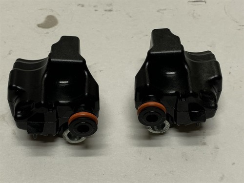

HD M8 head breathers

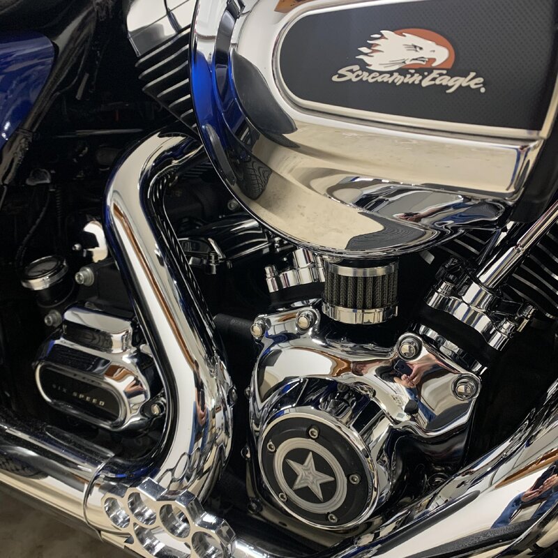

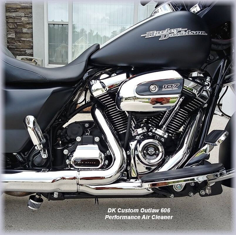

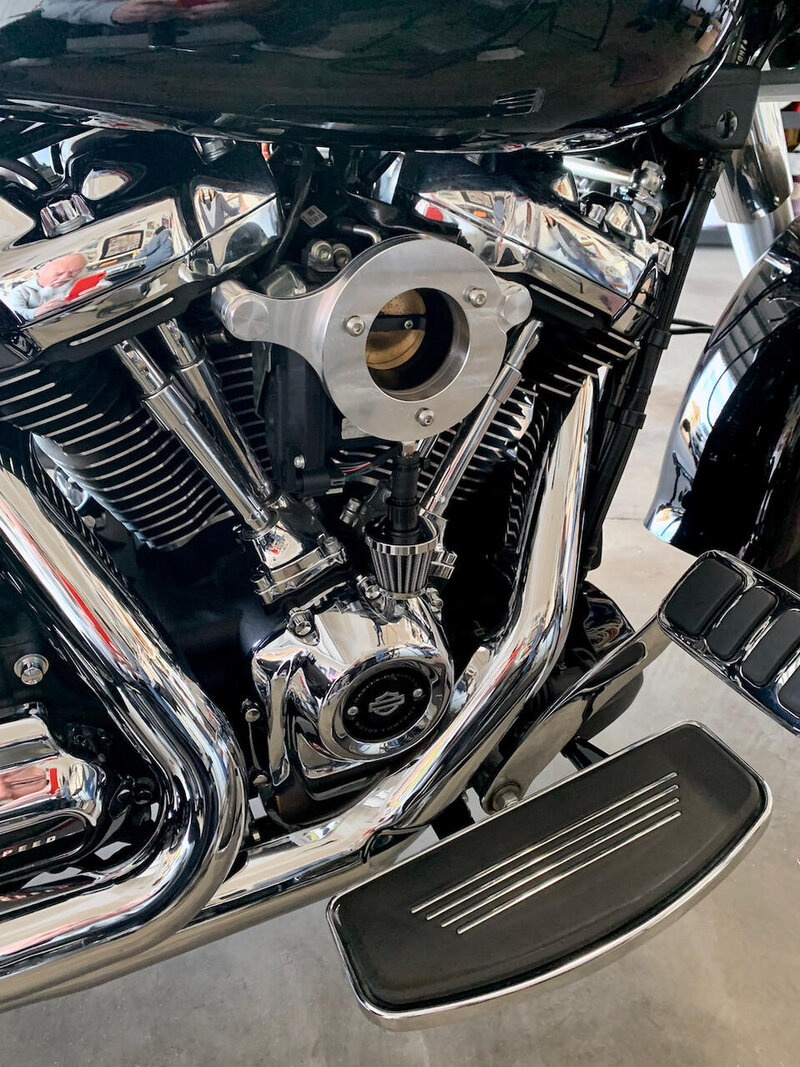

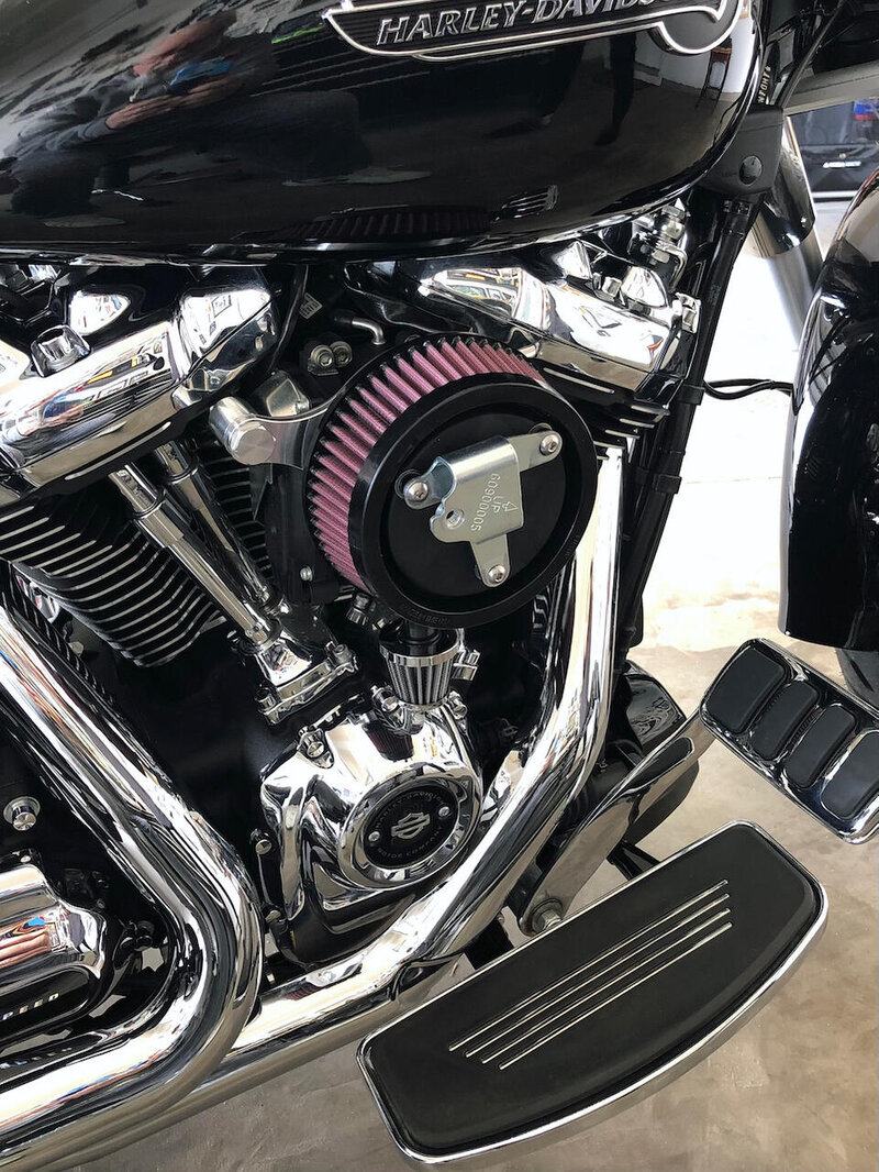

So 1st of the year I'm planing A DK 606 Naked Air Intake with External Breather System. This Air Intake allows me to retain my stock air cleaner cover, which I like. My plan was to run the EB hoses up, under the tank and terminate with the filter hanging in the space behind the rear cylinder above the Starter / Trans cover. A great spot to highlight the breather filter (which should be chrome) ... i have seen this setup on the DK site but anything dripping won't work for me. My choice to go "up" with the hoses is because there is no other way to hide them ... any comments are always appreciated. Thanks
Good choice with D K Customs products
This is just my opinion, let gravity work for you to expel the oil and condensation
Running the hoses uphill makes no sense to me, there is not alot of pressure behind the mess getting expelled, this could IMO be counter productive ( it will not get sucked back into the engine, but it will take longer to get to its final destination)
We have been venting Harleys down and open at the end with no filters for many years, sometimes reinventing the wheel does not work out as good, JMO
Let flow dynamics work for you
View attachment 115850View attachment 115851
I agree with Jack. What ever route you choose, let gravity be your friend.
I agree with that ... it only makes sense and looking at RK's pics is exactly what I would like to do. Looks great, least amount of hose to run, perfect ... but ... I can't do that and still retain my Air Cleaner Cover. By changing out the cover to the Screaming Eagle now there's room for the filter or catch can. With the stock cover there's no room to do that. Am I correct?

You could run that with your stock cover and backing plate, you would have to drill a hole in the bottom of the backing plate for the hose to exit

If you were referring to my cover as a SE, it’s not, just a stock Rushmore with a dress up insert. I would think that your cover with the 606 would be basically the same. Check with DK and you will know for sure. Good luck and be safe.

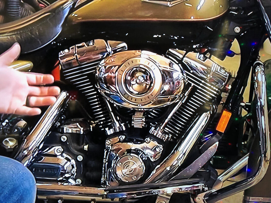

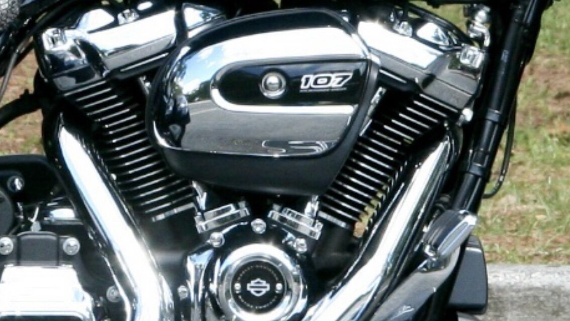

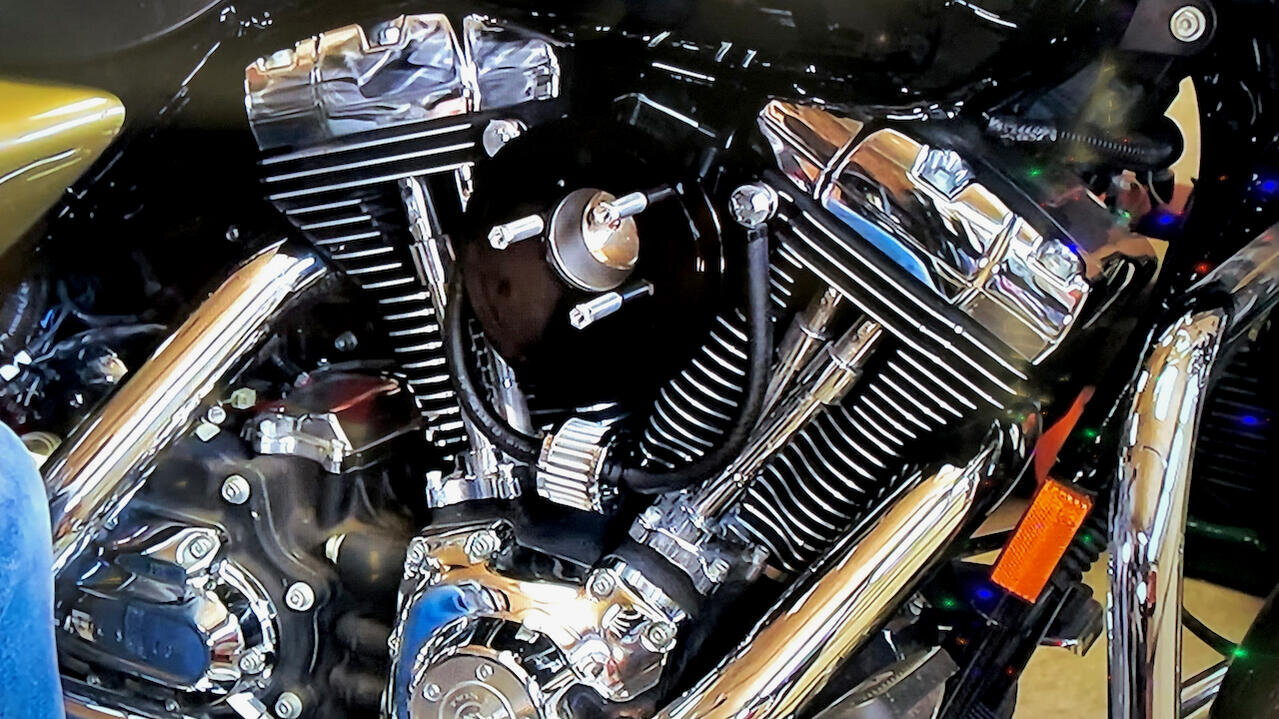

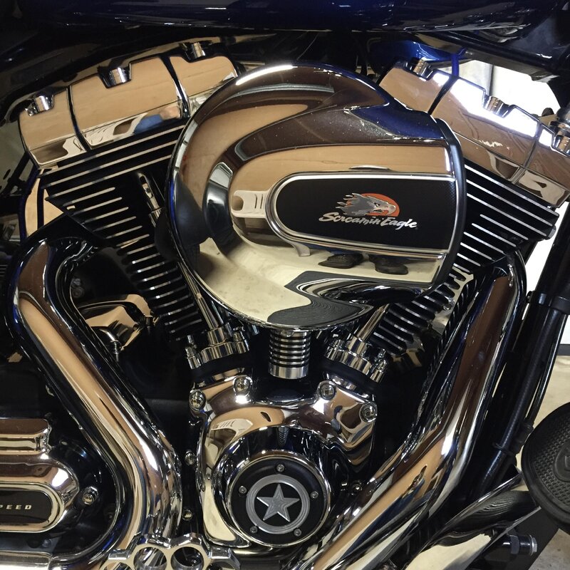

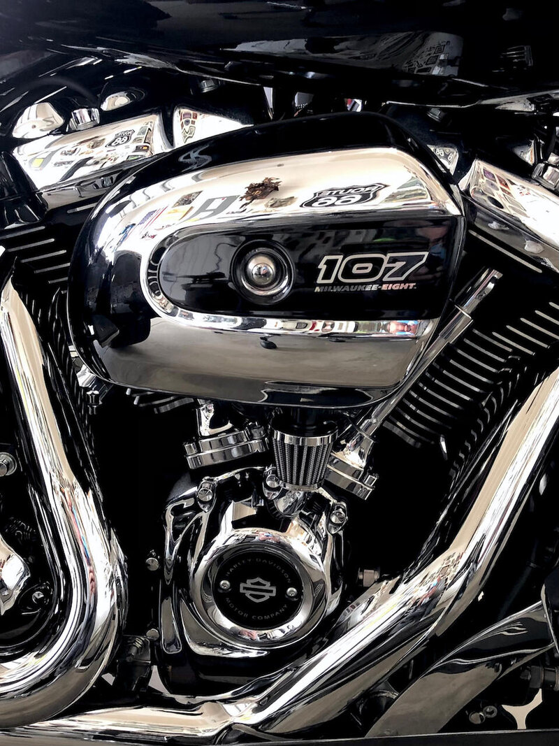

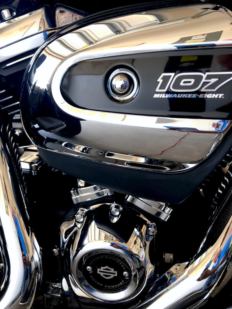

Good morning ... so I would really like to be able to install the breather filter so it sits below the air cleaner (a la RK's) Using the DK Naked 606 allows me to use my OEM cover (minus the giant black plastic backplate) This now gives me extra inches below the cover. Anybody done this with a stock M8 cover? RK has the Rushmore Cover ... This guy has the Football Cover. Any input is always appreciated.
