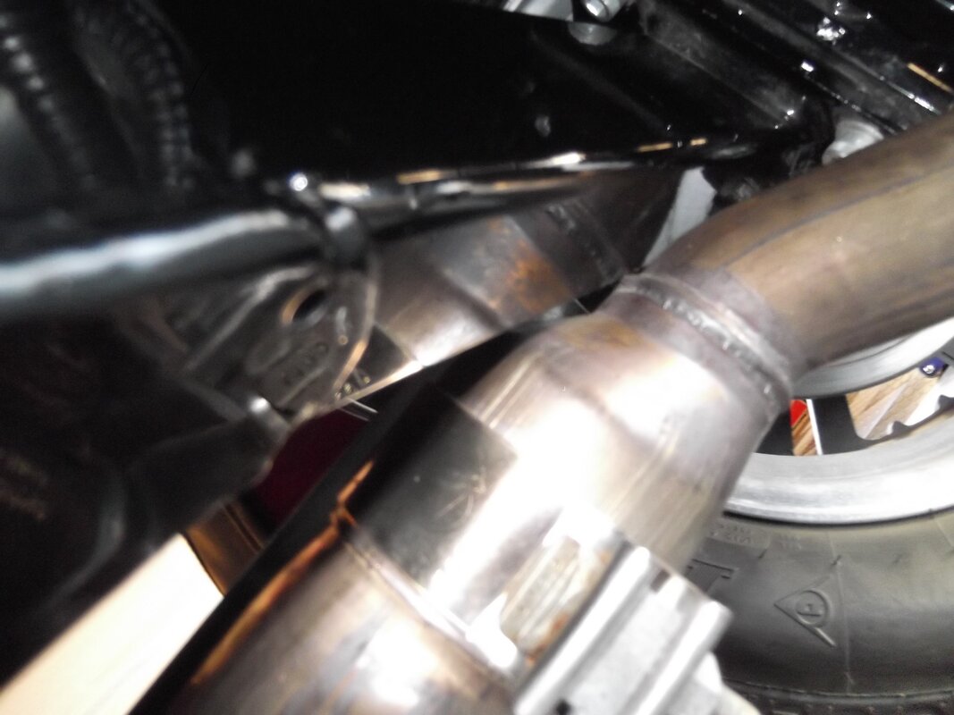

2017 tri glide 5000 miles was putting new mufflers on saw that this was touching frame. I had just put on lift kit brackets less shocks. This might have been this way since new I don't know, muffler lines up and is straight.Any thoughts?? Hope picture comes thru.

Looking at your photo...this is not unusual for the 2017 and up models. HD is making larger than normal weld beads on the exhaust and it usually has the swingarm barely touching that weld bead.
Once you get the tires on the ground, and some weight on the suspension, that swingarm will lift up off the bead.
Some folks will takes just a little (1/16"-1/8") of the extra metal off the bead with a file or grinder...but there really is no need for that.

Thanks Kevin, will check out video. (mine is actually resting on the frame)
