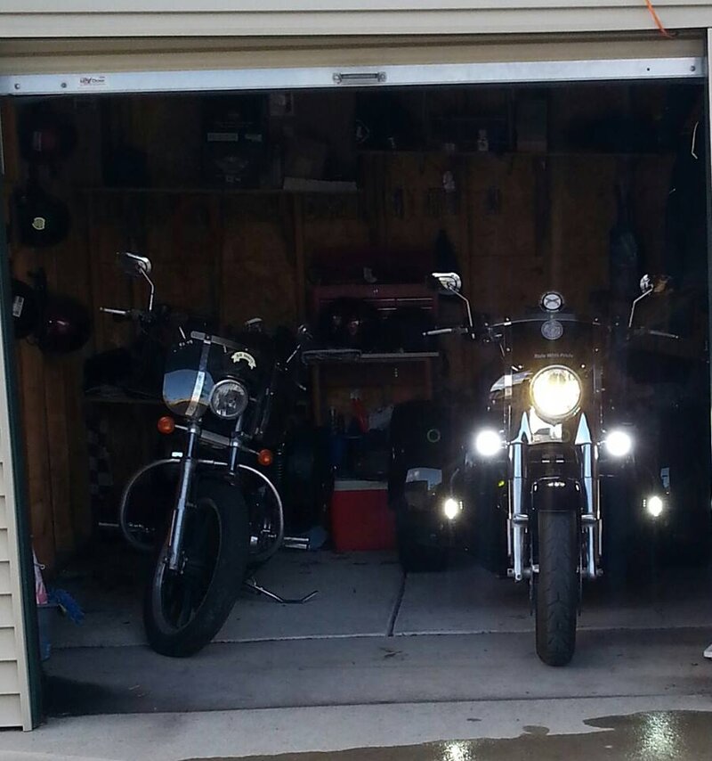

And if you can't afford top line, you can get similar benefits by just changing the bulbs.
BEFORE
AFTER

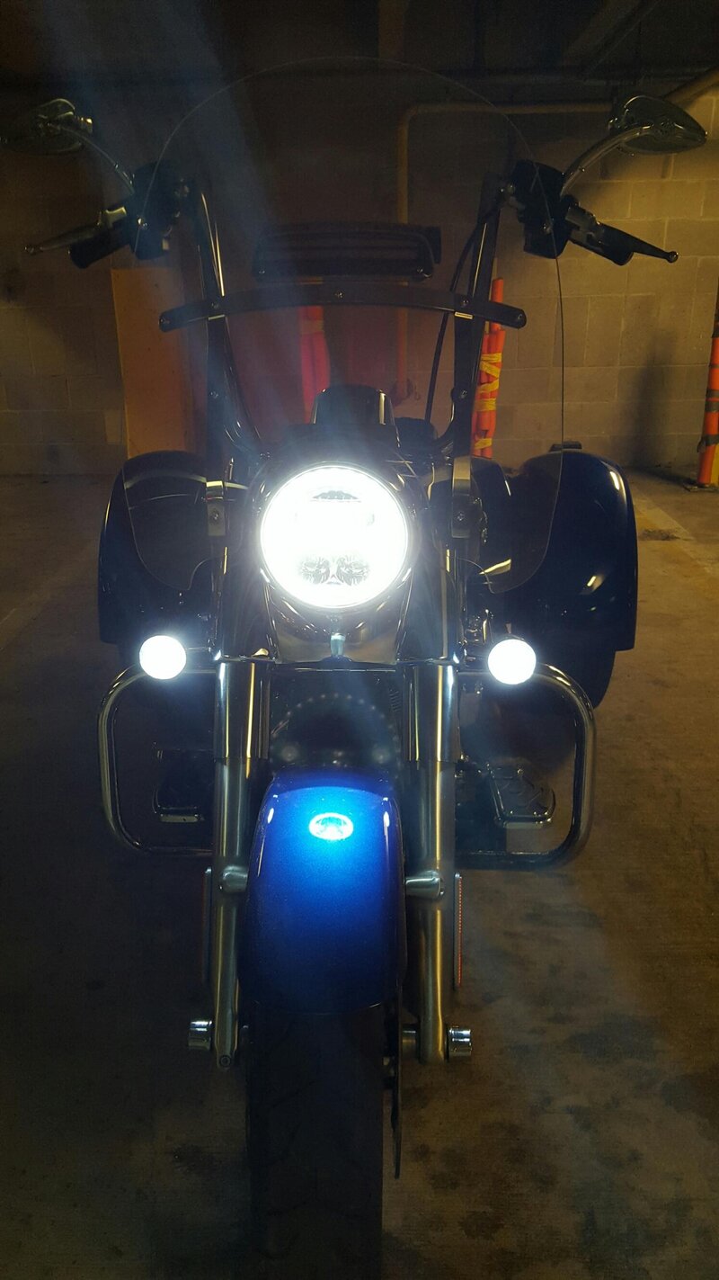

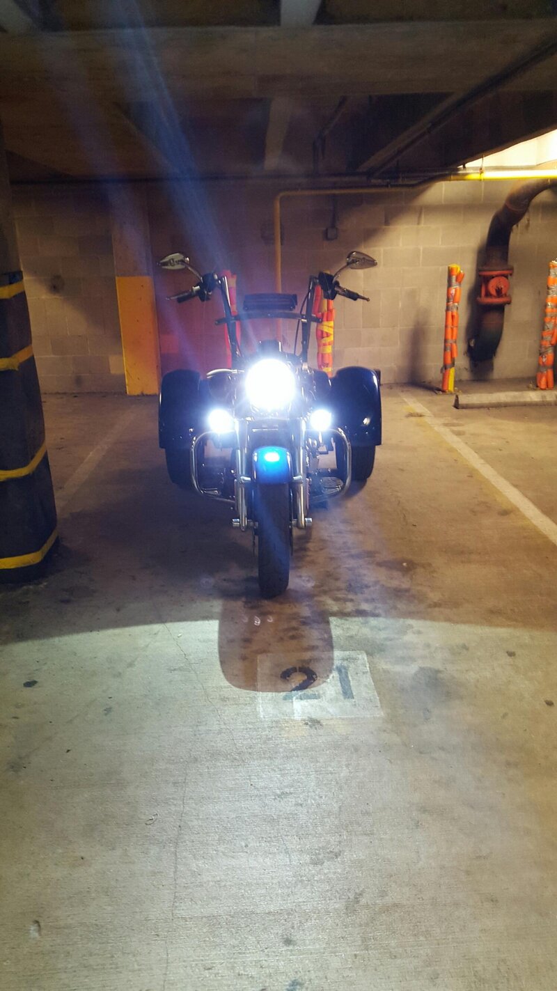

All LED lights up front on my FLRT. Installed the HD "Daymaker" headlight, Custom Dynamics GEN200-AW-1157 LED turn signal/running lights combo and the Cirius USA LED lights on my engine guard. Almost hurts to look at it!
For real, those will brighten up your life. I do a lot night riding, and you can see nearly as well as you can with cage headlights. I had them program my TG so that I could turn on brights and the passing lights still stay on.

Looks great, how did you wire them up, did you put in a switch and wire to battery or to the head light or what???
The headlight and turn signal/passing lamps are direct plug and play into the OEM lights.
Engine guard lights are simple run to the battery with an on/off switch and fuse.
