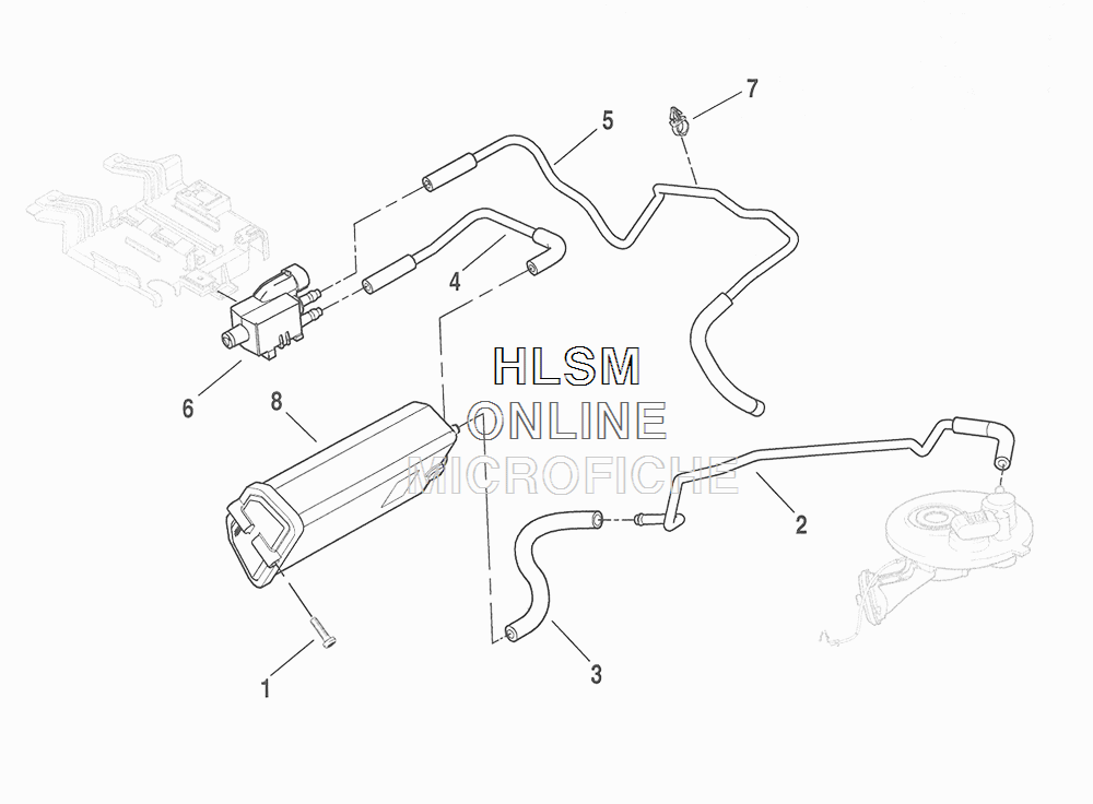

The Ca models have a fuel Evap system similar to and automobile for emissions control
Thanks Jack. Is that a big deal to remove? And would that affect anything? (I'm assuming the '15 is pretty much stock) And of course I will ask the seller.
No it will not be hard to remove, however if you take the purge solenoid out it may set a check engine light. Look here @ this picture. #6 is the purge solenoid.

There is also another solenoid inside the gas tank that the vent hose connects to. I have disconnected the hose (PC 2) before it goes to charcoal cannister and run it down to the ground, but it still takes forever to fill the gas tank. Add about 20 cents worth of gas the rock the bike side to side to get it full. I was afraid to disconnect the solenoid in the tank, didn't know what it might do to the ECM. PC 5 hooks up the the intake after the fuel injectors.
