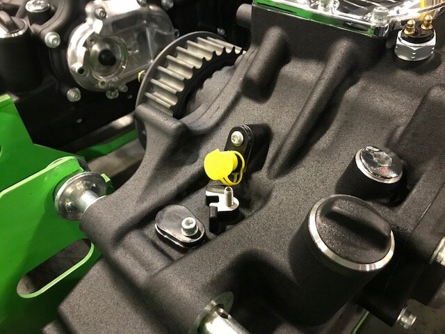

I am looking for input. The M8 motors that are oil cooled feed the oil from the heads back into the system at the back of the motor thru a tube. The water cooled have the same port but has a cover plate over it. I was considering buying that tube and feeding the breather into it. My concerns are feeding that hot air/oil back into the oil re circulation system, and what would the pros/cons be.
opinion?
Also which is better if I go the normal route , the breather filter or a catch can?
Thanks

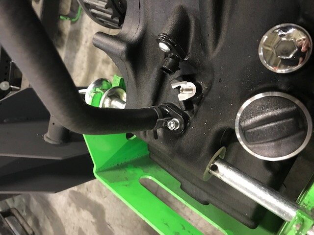

Kevin also replied in a message with a picture of the water in the oil at the breather. I never thought of the water content. Will NOT consider running the lines back into the system. Thanks guys for the replies. I will modify my backing plate and run the hose to under the motor, probably try to follow the fuel tank hose out the bottom. I just need to figure out whether to use a can or filter.
