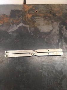

That tool is kinda of clumsy with smaller calipers. Have you tried using a needle nose pliars? I found the points work good on some smaller pistons. The caliper piston tool I have can be used with a 3/8 drive extension and ratchet. A lot of the cheaper kits have 2 holes machined into the piston plate, I do not like this set up. This is what all of my discs look like

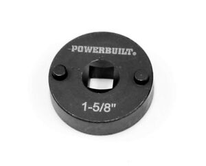

Jack, do you happen to know the size of the disc that is used on these pucks? 19 Tri Glide. I have 18 discs in my kit and none of them fit the puck the way I think they should fit. None of them fit flush. Only two are even close and have the right size pins
No I do not, I have not replaced these brakes yet. if you can measure the diameter of your piston I will check my set to see if I have the right adaptor;)
Dale, my smallest adaptor is 1 1/2 inches, it is double sided having different spaced pins on either side, it has a 3/8 square drive center for use with a ratchet also
I have two inch and a quarter adapters that are the size of the puck but only one has pins that are real close to fitting. The adapter will fit on the puck but the pins don't line up exactly like they should. I'm not happy with the way it sits on the puck

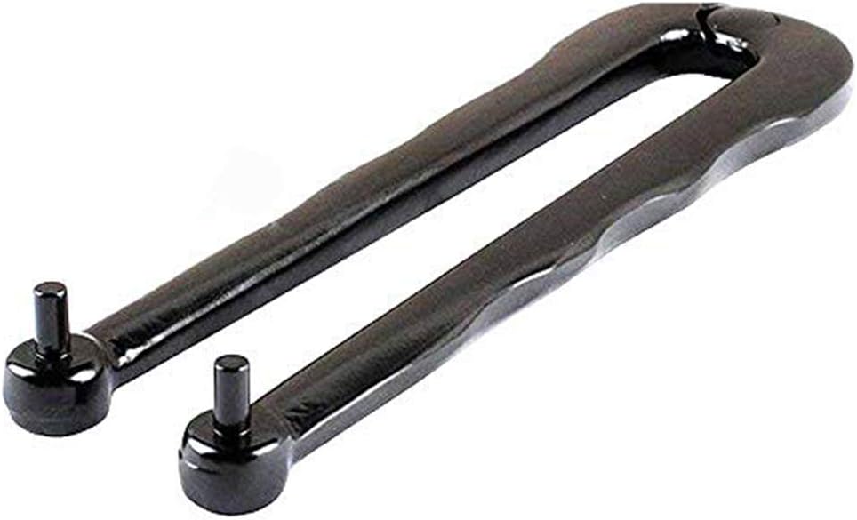

I also had a Snap On Tools Spanner wrench that worked on many calipers
I'll be darn
I haven't done brakes in a long, long time. However, looking at examples of the required tool, I see the same thing that I used for many years on my boat. It was used to open the flush deck plate fittings for fuel, water, and holding tank pump out. I had a couple of them that were adjustable like plyers with two different sized pins. I also had several that were relatively small with fixed pins. The small ones were aluminum and the larger was bronze. Perhaps one of the adjustable marine deck plate tools could be an answer for all brake pucks.....? Google "Marine adjustable deck plate tool" and look at the Sea Dog bronze Adjustable Deck Plate Key. Price I saw was $30.99..... Jim
