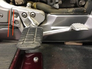

Whatever pedal you have, below is a picture of how it should be adjusted in reference to the frame. Notice that the back edge of the pedal is parallel to the frame. Anything other then that may cause less then full pedal movement in an emergency situation. This is import for 2 reasons. If brake fluid loss were to occur, one may need a full pedal stroke to stop, since it might be ones last attempt at stopping. Also, when manually bleeding brakes during a service, full pedal strokes makes the job easier. Often, an incorrectly adjusted pedal, will causes it to hit the frame and not allowing for full movement.
Below is an OEM step and pedal

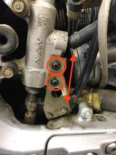

David357 how do you adjust the cruise/brake light pressure plate?
Thanks
Not David but hopefully this will answer your question. To adjust the switch plate, loosen the 2 screws shown in the circle and slide the plate up/down to make your adjustment. Honda says that the brake lights should come on when the "toe" of the lever is moved from it's neutral position downward between 0.02-0.06".
FYI ... using any screwdriver bit other then a JIS may strip the screw heads.
