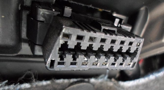

More info would be a big plus. Does this scooter have a diagnostic port similar to this

Hi Jack, thanks for the interest mate. 3 x techs have diagnosed the sensors as ok. The first one found a faulty O2 sensor and replaced that, the other sensors all read ok. Yes, the techs have tried for codes and come up empty handed. No check engine light. Yes, it has a diagnostic port similar to your pic. The ECU can be read but nothing can be changed, or at least I haven't found anyone who has the equipment to change it. It may not be "locked up" but evidently it's faulty. An after market unit would probably fix it but the problem being there is a second ECU for the auto gearbox and we need to find a unit that will talk to the gearbox ECU. Quite frustrating! Cheers
