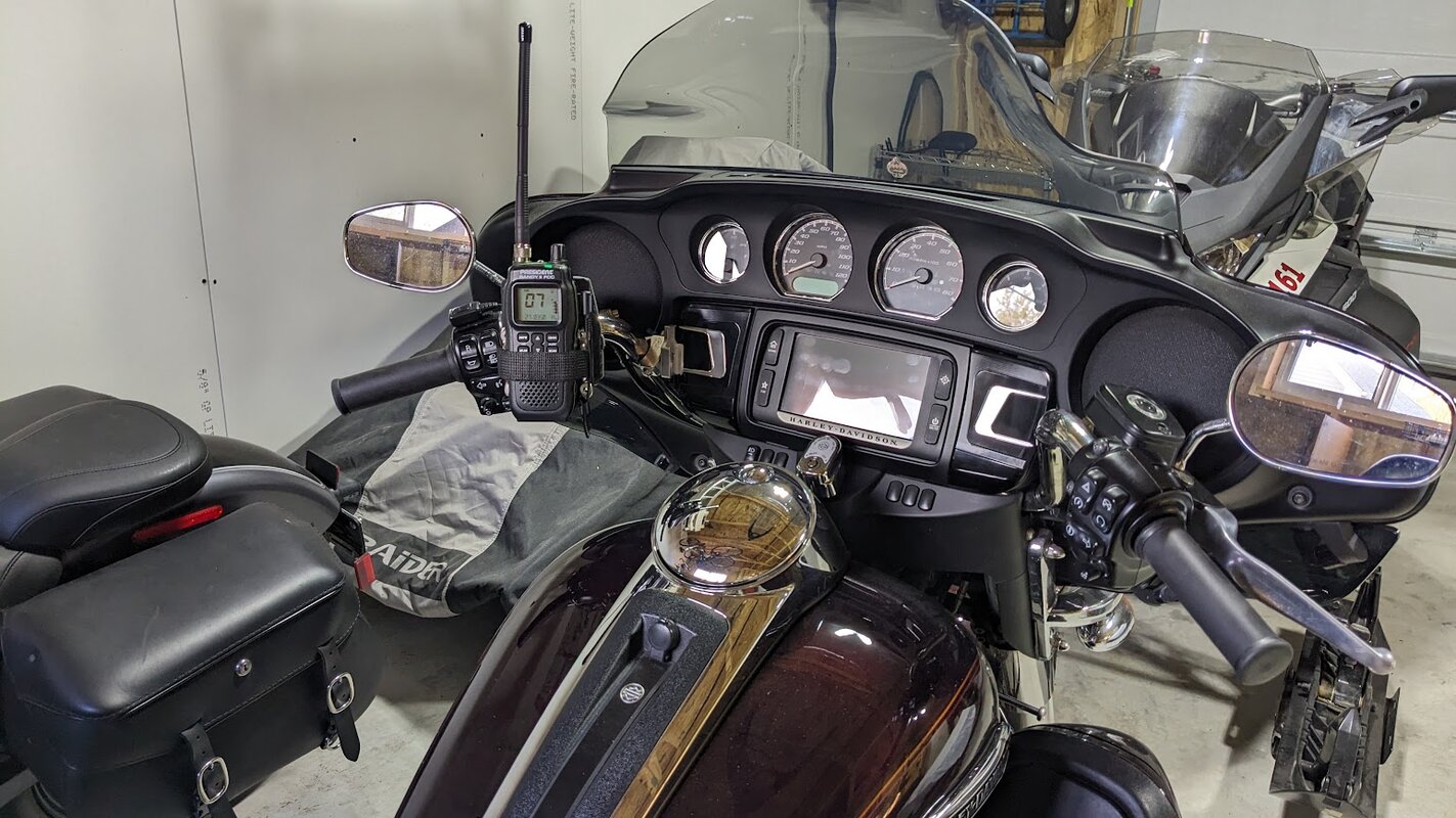

SmittysTrike, I also wanted a CB and could not find the factory HD module for my '14 Tri Glide. Not sure if Harley quit making it or not?
What I did was buy a Sena SR10, a handheld President Randy CB radio, and a SR10 cable to connect the SR10 to the CB. The Sena's "Midland" cable fits the President radio.
https://president-electronics.us/CB-Radios/AM-FM-transceivers/RANDY-II-FCC
https://www.revzilla.com/motorcycle/sena-sr10-bluetooth-two-way-radio-adapter?sku_id=800363
I put the CB on my phone mount and use the SR10's detachable rubber mount to mount it the handlebar. The SR10 connects via bluetooth to my Sena helmet headset and I have a PTT button that velcro's atop the handlebar's left switch housing.
I can listen to music, talk to my wife and if someone calls on the CB, the SR10 dims the conversation and I can hear it. When the CB conversation stops the music or wife return. If I press the PTT button, it disconnect the music and transmits thru the CB.
This setup works pretty well, and it's very portable. I can switch the whole setup from my trike to my Softail in a couple minutes. It's hard to find a Sena SR10 anymore, though. I think they quit making them? Might find one on E-Bay if you (or your friend) decided to go this route.
Good luck.

That certainly looks like another option. Will keep it in mind.
It takes up more room than a phone, but isn't as obtrusive as one might imagine. The PTT button is easy to reach on top of the switch housing, too. SR10 is hidden behind the CB.
