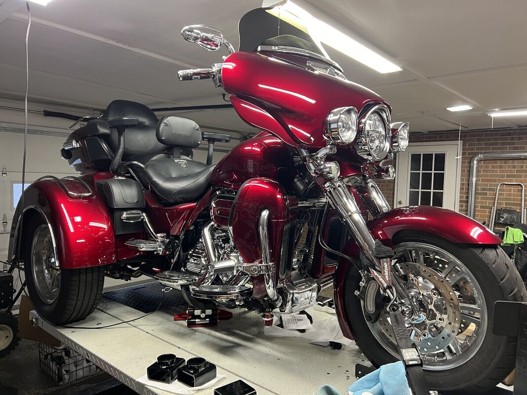

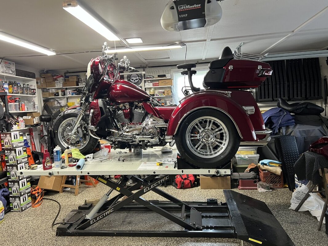

My buddy ordered the Redline 1500 lift. We studied a few and he decided on that choice. It came crated very security. You better have a forklift, Bob-Cat, heavy front loader, or something like that to unload it off your trailer! It is one heavy puppy in one crate! We put it together in an hour or so. The only thing we did to the lift was paint the surface with a ‘bed liner’ material, because the top was slick. We have used it a couple of times and I have enjoyed working on the trike with it raised. If I ever get a bigger shop to where I could have one, I would order the same one, unless something better comes out in production later on.

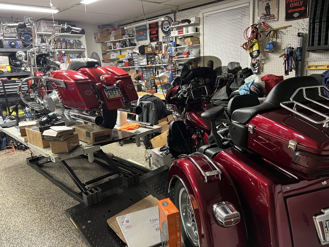

I use a Weaver Lift. Free shipping which most companies charge. The Old Dominion driver put it right in my garage. It uses an air compressor driving a hydraulic system. Works flawlessly.

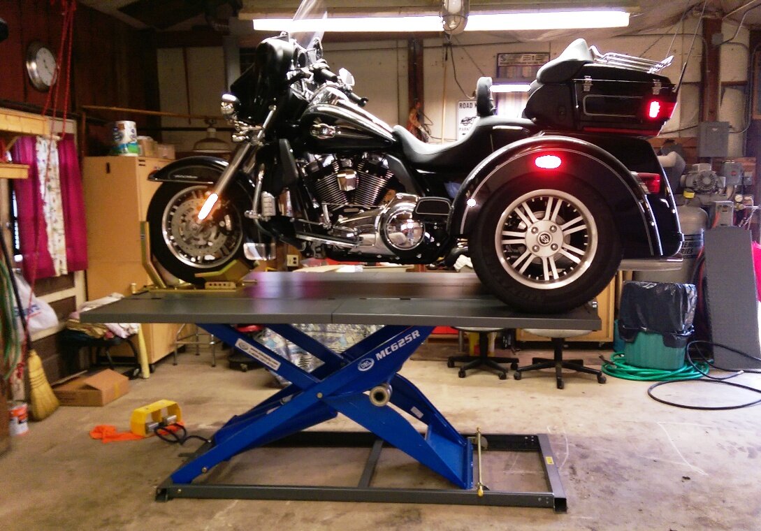

I have a K&L MC625R lift. It has a 1850 lb. capacity and is air over hydraulic system with a foot peddle.
It has split sides so you can use all 4 or keep the front or back 2 on the lift while working.
The drop down panels on the front and rear are nice for working on the bike too. With the front chock,
the front wheel drops down to the floor so nice while still in the chock.
I have had it for about 8 years now and use it for everything. Lawn tractors, zero turns, golf carts and anything else that comes along. Its a must have for me with back issues.

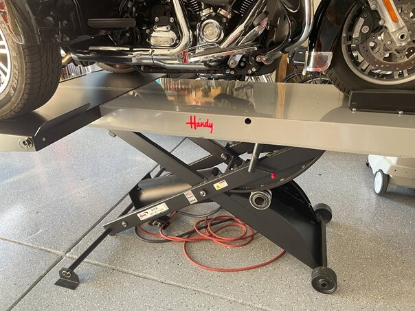

I have a Handy lift that is rated at 1000 lbs, I have installed outriggers on it for the trike and have had zero issues with it. Now keep in mind even though it says 1000 LBS lifts like any lifting device is under rated for what it will actually lift. So the Tri Glide is rated at 1250 lbs being 250 pounds over I didn't even give it a second thought.

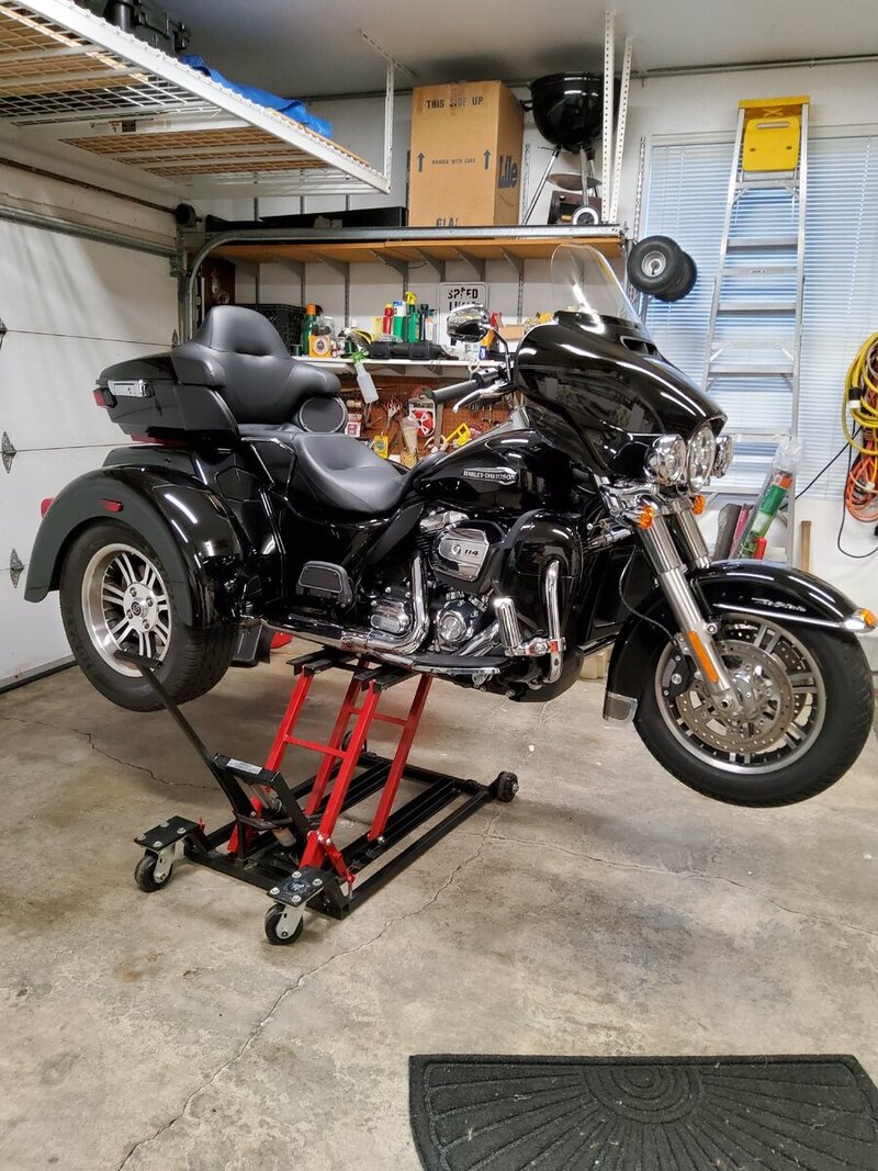

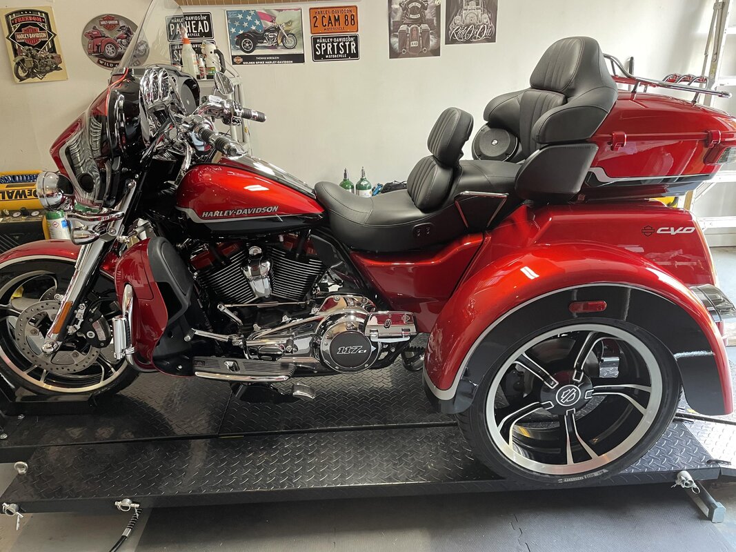

That is a sweet lift. I wish I had room to have one. I use car ramps and a Pitbull jack for Trikes. It's as good as it gets for now
Pit Bull Lift Pic.jpgPit Bull Trike Jack.jpgpitbull trike adapter installed.jpg

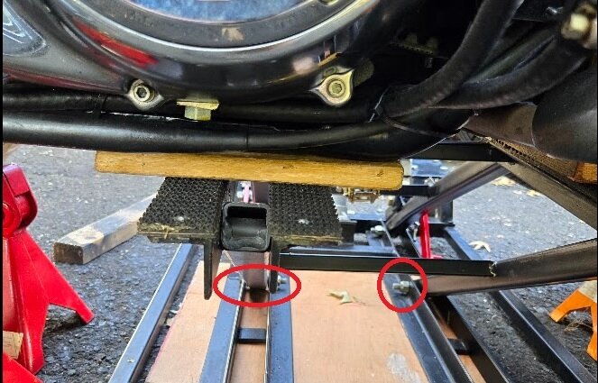

I have the pit bull lift and found the weak point is the area circled. The weight of the trike bares down right there and will slowly bend the pivot point down and the angle of the bike starts to tilt. I slip a 1/4" piece of plywood under the lift to take the weight off that point. I think mine bent while testing to see how stable the trike was with the lift as high as it would go. If you only lift the trike high enough to get jack stands under it you may not have that issue.lift.jpg
That is a sweet lift. I wish I had room to have one. I use car ramps and a Pitbull jack for Trikes. It's as good as it gets for nowView attachment 129883View attachment 129881View attachment 129882

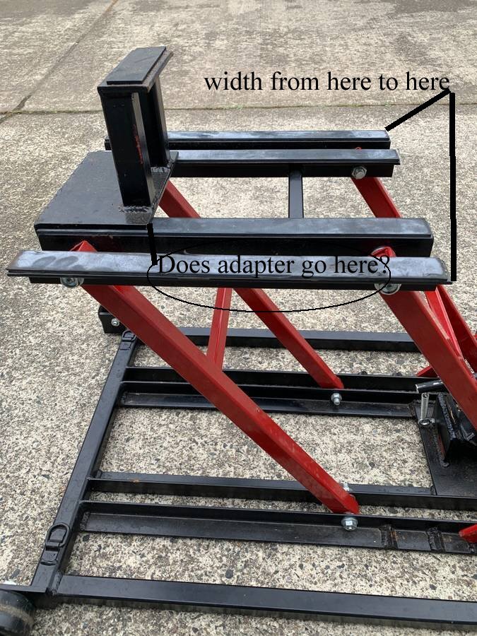

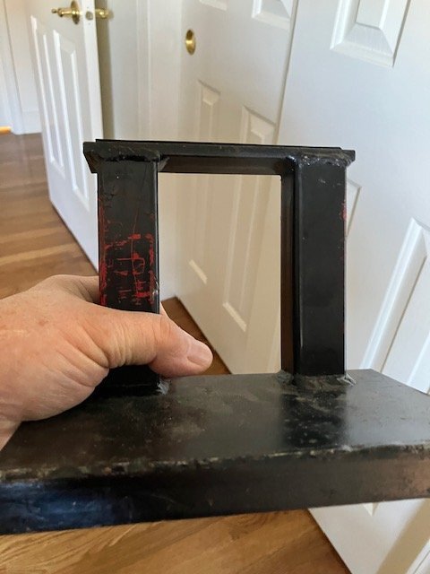

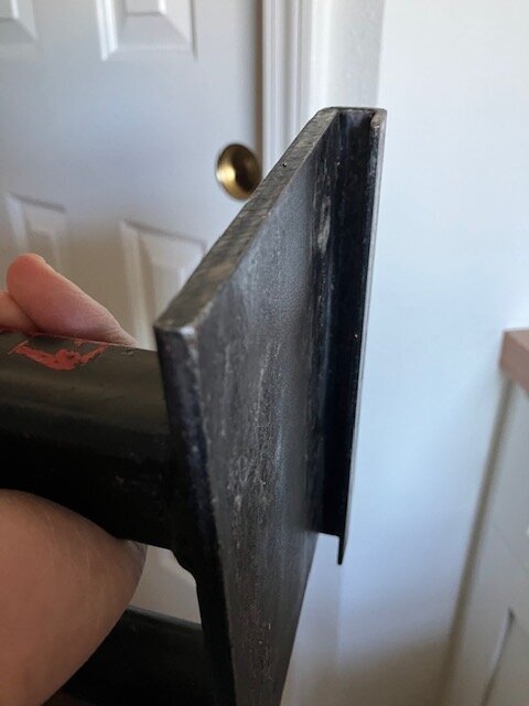

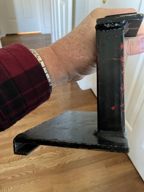

Thank you Hobo98498 for these picture. I have a J&S Lift for two wheels. This adapter will be perfect for my jack lift after llooking at your second picture. The first picture confuse me a bit. I think this adapter goes parallel with the arms. Going to attempt to make one. Can you please confirmed the measurements ? Is 6 inch tall and length ? Thank you!!
The first picture (above in first post) the adapter is setting on the bars incorrect. The 3rd picture shows the adapter installed across the bars that would go under the cross over pipe. It also has to clear the pipe clamp, so there is no room for mistake for clearances.
My adapter with rubber pad is 5.5" in height. I think that would be the minimum height since everything is tight quarters. You can adjust height in increments with rubber pad.
The base is 8X5" and constructed with 1/4" steel.
The upper platform that the trike sits on is 2"X6"
I have the pit bull lift and found the weak point is the area circled. The weight of the trike bares down right there and will slowly bend the pivot point down and the angle of the bike starts to tilt. I slip a 1/4" piece of plywood under the lift to take the weight off that point. I think mine bent while testing to see how stable the trike was with the lift as high as it would go. If you only lift the trike high enough to get jack stands under it you may not have that issue.View attachment 129949
The circles that you displayed in your picture will bend and create an issue if your floor is not level. It also appears that you have a piece of plywood under the jack. My question would be if the wheels are digging into the plywood as well? That jack has to be on a perfectly level plane no lumpy concrete or cracked concrete or gravel.
Nope. This works fine. A lot lighter also.

Just watch the bottom pivot points that they're not bending. It isn't too noticeable the first few times you use the lift. If I had the chance to start over. I'd slip a piece of plywood that would just fit between the jack and the floor from the start. Also use floor jacks to support the trike asap after getting the trike where up. I think my problem was because I jacked the trike up and left it up on the jack for a few days while I did a deep clean and pulled the pipes off to remove the cat. Trike was very stable and I wasn't getting under it so... Lesson learned
Gotcha, plywood to brace under the pivot points. Makes sense. Thanks again.
I hope this helpsView attachment 130511View attachment 130512View attachment 130513

George, I’m looking at the last picture and wondering…are the upper and lower plates parallel? The top plate looks like it’s mounted at an angle. Maybe just an
optical delusion.
