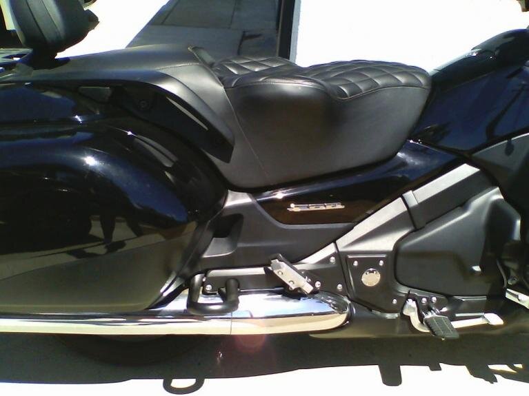

I am only 6-2 , but I am a double amputee, I had my seat modified to set me back 1" and up 2". then we took kury floor boards , cut the bracket in half, add 2" inches, and had then rechromed. since I am an amputee, the forward controls would not work with my pingle shifter. rides very nice now.
