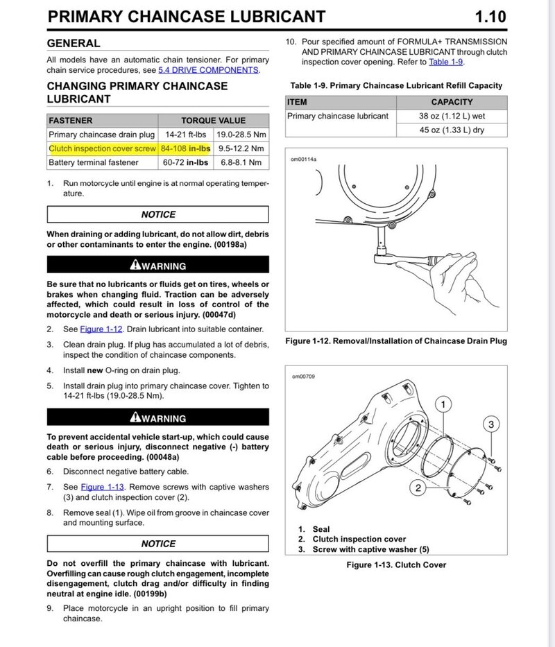

And the 5 bolts on the derby cover torque spec is: 84-108 in/lb for the ones who want to follow what’s in the service manuals. (Important: that’s INCH pounds…. Not foot pounds).

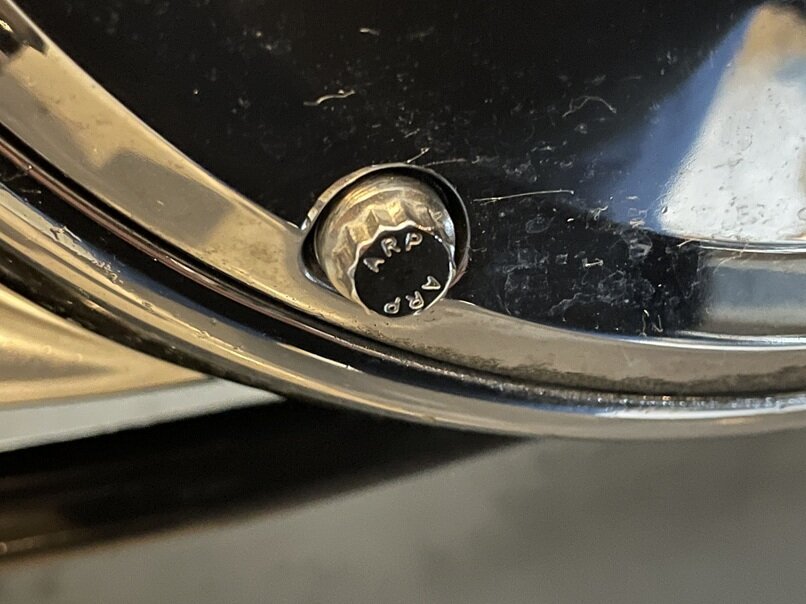

I personally did order a complete 12 point show-polished bolt kit from AlloyBoltz myself just because they do look great & that is just one of my winter upgrade/changes this year… not because I need them, but just because I wanted them. 👍🏻👍🏻
(The previous owner had all the chrome covers that utilizes silicone to hold them on, and I wanted to get rid of those chrome caps and replace them with those 12 point bolts instead.
Pic from my 2014 Service manual,… I believe these specs have been the same through many years,…. so my disclaimer is:
Please double check the year that anyone has to verify the recommended torque specifications if they choose to use an inch pound torque wrench.
