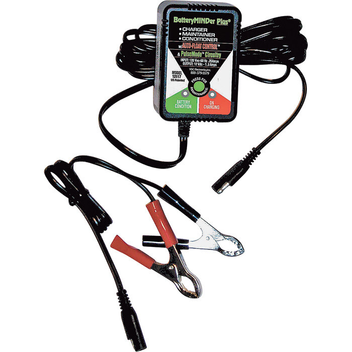

This is the one I use and have never had a bad battery that it did not detect... I use mine 24 / 7 / 365 as they do not cook your battery.... I have a number of them on everything... all bikes & trikes, Boats, Cars & Trucks and my gate battery... they also do fine on Deep Cycle Batteries.... They are available at Tractor Supply & Northern Tool / I've tried Battery Tender Brand and they do no work correctly... http://www.northerntool.com/shop/too...2201_200332201
BatteryMINDer Plus Charger/Maintainer/Desulfator — 1.3 Amp, 12 Volt, Model# 12117

I've had that kind for at least 10 years. One sorta fried about 4 years ago but the other 2 are still working fine. Supposed to de-sulfate as well or something like that but have no idea if it did on any of the many batteries they've been on. Always want to replace that one so maybe this is the time because price was stopping me.

This is the one I use and have never had a bad battery that it did not detect... I use mine 24 / 7 / 365 as they do not cook your battery.... I have a number of them on everything... all bikes & trikes, Boats, Cars & Trucks and my gate battery... they also do fine on Deep Cycle Batteries.... They are available at Tractor Supply & Northern Tool / I've tried Battery Tender Brand and they do no work correctly... http://www.northerntool.com/shop/tools/product_200332201_200332201
Thanks for the great write up Bob.ThumbUp
I just placed an order.
All to yourself Baldy....
LMAO no, I do have 2 already, not that make, and I will certainly keep one for myself. Need just one more for my generator battery as well as 2 deep cycle batteries. The generator has a cord charger but it won't stretch to the shed.
PS They are on the truck be here shortly.
