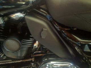

I have always used the same adaptor for my Gebrings heated gear and the battery tender jr. Here's the setup I just installed.
Cost of this was less then $20.00 and no more wires to mess with.
Looks great-nice and clean. ThumbUp
Unfortunately I don't have those deflectors. I replaced them with leather "crotch coolers". I do have the 2-prong plug (Battery Tender/Gerbing)wire tied to the passenger handhold in that location though.
Wire plugs are not a problem for me and are not noticable.
I seen those plug in connections for the heated clothes..Great pics..No problems with the heat melting the back side of the plug??
