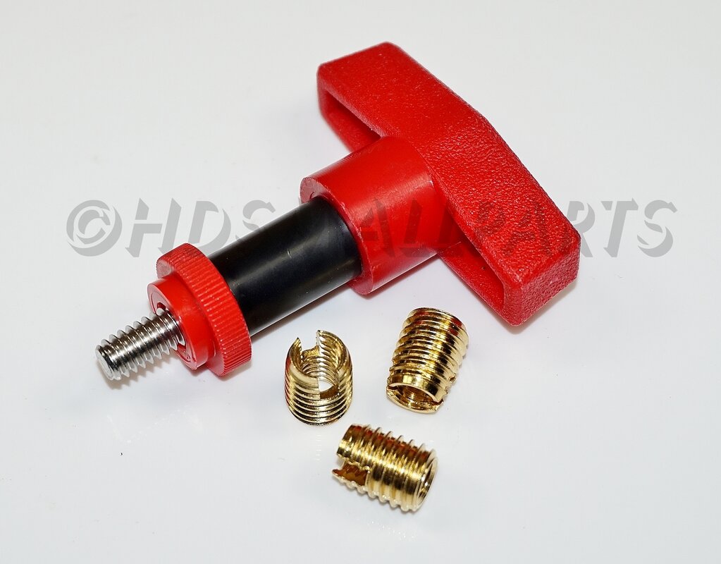

Maybe they have changed. I tried to find one and the instructions I had for it, moved almost three years ago and obviously they are still packed away(the insert and instructions). I put one in my 2008 FLHTP before but the insert was solid brass threaded inside and out and slotted for a flat blade screwdriver to install it. You drilled out the old insert or the hole it fell out of. Brass so it comes out easy enough. Can't remember though if the insert was self tapping or if I tapped it prior to installing it. Probably tapped the plastic since the insert was bass. I got them at the dealer cheap enough for H-D stuff. And the parts guy gave me an instruction sheet with it. Had the drill size and depth and I guess tap size if it wasn't self tapping.

Only one's I have ever seen also. Brass & they worked very well,did not crack the fairing. Maybe the ones for the W/S are diff. ones I had to replace were the "mounting" holes for the frame
Those look exactly like the ones I got from the dealer. You could buy just one from the dealer if you wanted. And to my surprise only about $3 apiece. Guess I didn't use a tap, been awhile. Also I didn't have the insert tool just a flat blade screwdriver. And I used them for the windshield. Luckily no others were loose. They are solid in my opinion, better than the stock ones that came in the inner fairing.
