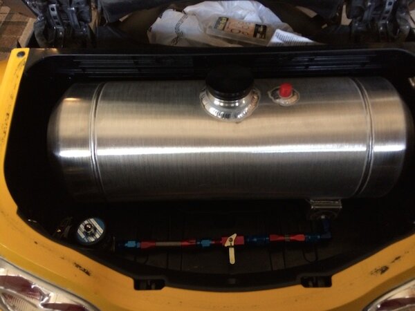

well I add the tank here is my setup,

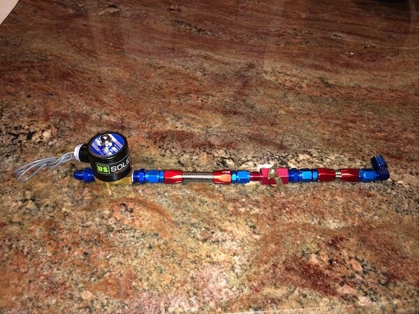

This is just to show shut off and solenoid valve that is connect to tank
The Red port on top is vented outside of trunk just not shown in photo

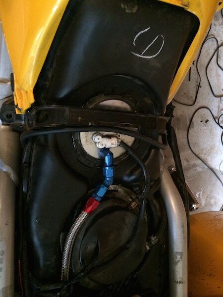

as others of done tapped into fuel sending unit to fill main tank

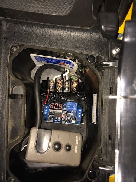

set up a delay timer that can be set up to 999 sec in right fairing pocket

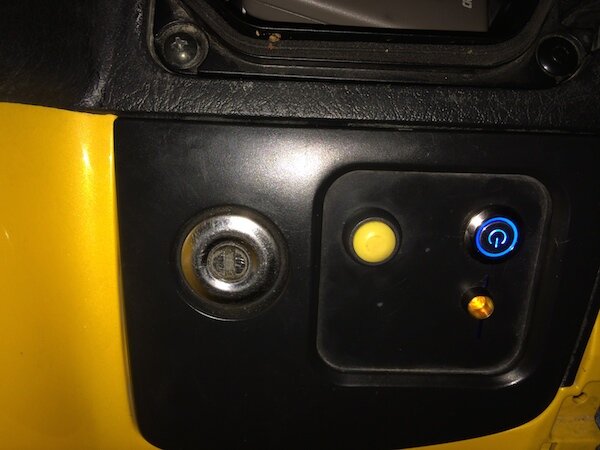

Installed push button and indicator light to let me know when valve is open.
Tank holds 4.7 gallons so when indicator light comes on for low fuel I push the blue bottom amber light below comes on to indicate valve is activated. Fuel will dump to main tank and after a preset time it will auto shut off.
