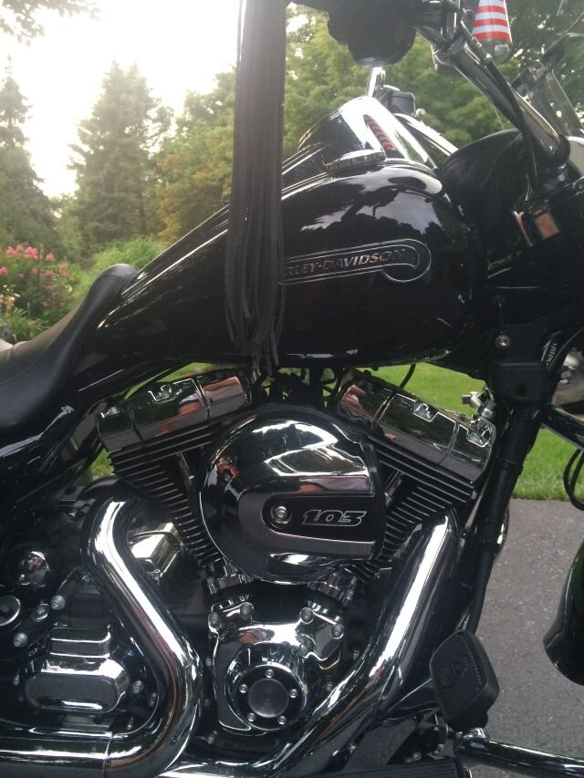

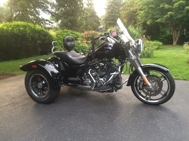

As promised, Pics of Blackie with DW 2" deluxe lift (Cobra 900s, too)
tank lift

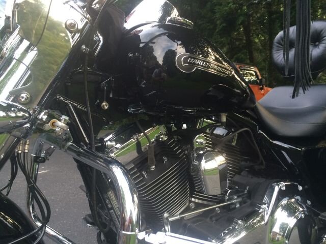

did your stock fuel line fit or did you have to lengthen it
in the picture there appears to be something black in front of your tank. What is it?
The stock line is a braided line and is at the rear left-side of the tank. I did not do the install because Iron Valley HD did it when they did the FP3 and other parts. I also checked the leftover parts and the long gas line is in the bag.
I think what you at be referring to is the electrical connection to the tank gauges in the front near the spark plug wire.
When I put a 1.5" lift on the 2006 Street Bob that I had the line had plenty of play; it is the same here. I made sure that there was only about a gallon of gas in the tank--that makes a big difference when you are trying to install.

Just love the response with the tuner, K&N and Cobras. Sound is great too. Makes me wonder what it is like for you guys who de-cat, have true duals as well as a fancy intake and a custom tune.
tank lift

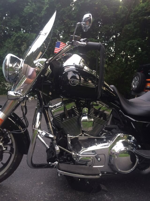

the black I am referring to is sitting on the top front of the tank between the handlebars and the chrome dash

Couple questions, do you really think it will help with the cooling of the motor ?
Raising the tank, how did it affect the front part of the seat. Isn't the front part of the seat resting on tank ? did it create more of a bend upwards on the seat ?
I have a small tool bag there for sunglasses and garage door opener. It is an old HD bag that would fit on the front handlebars at the "V".

The motor seems to be much cooler. I don't really notice heat until I am stopped. The rear cylinder seems not to go to the heat setting and shut down as frequently.
I think that the floorboard extensions also help. There is much more circulation around the engine and my lower legs are away from the engine. That always seemed to trap in heat on all my bikes. I added a 3 inch shifter peg to make it easier to reach.
I am not going to put any heat shields on until I put a few more miles on him.
The seat is a tallboy and it does bend a a greater angle but it still sits on the tank. There is a bit more crease in the seat but it is not problematic.

Thanks for answering my question. I could not for the life of me figure out that is a small tool bag and it looks good as does the whole bike
Tank Lift
How difficult was it to do the lift at the back of the tank at the seat? How well does the seat fit after lifting the back of the tank? How well did the lift reduce heat?
