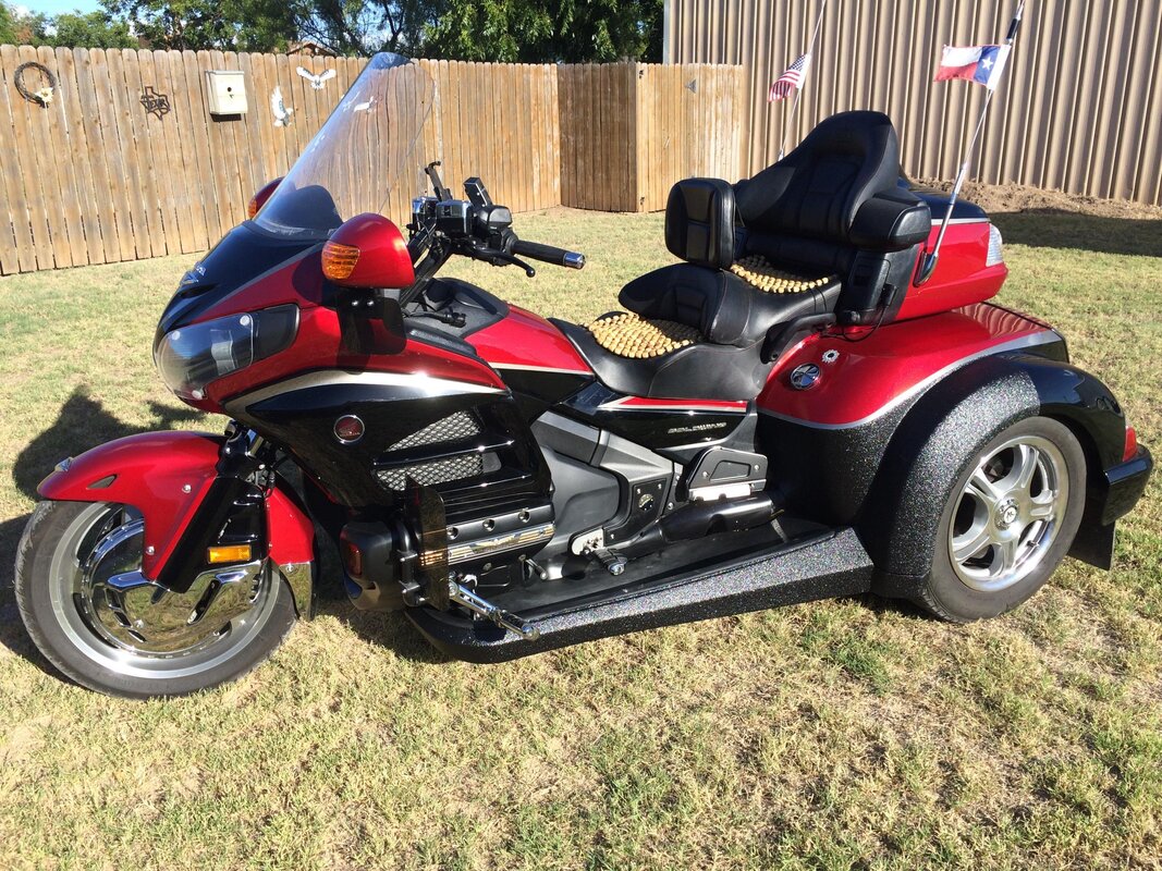

If you ride in an area prone to getting paint chips you might consider having the Wing Guards shipped without paint and have them covered with Line-X. I just had mine done because they were getting chipped up real bad. Here's a picture.... As you can see; I also had the front of the fenders done. :xszpv: :xszpv:

As GOLDRUSH said, The LINE-X will hold up a lot better than paint.
I think I paid around $100 for Line-X a couple years ago.
Mine was done in DARK BLUE.

I just had mine done a couple weeks ago so YES they do need to be off the trike for coating. Doesn't take very long to do but in your case that's probably a non issue. :) I've tried a few different methods to prevent rock chips. This Line-X looks like the most positive. It protects well and cleans up easy... :xszpv: :xszpv:
If you do the front of the fenders like I did you'll probably need to trim the side covers trailing edges so they do not rub on the fenders. Again, not a big deal and easy to do...
Also, make sure the Line-X folks do not cover the very back that would mate up with the fenders. It's OK to go ahead and do the fenders themselves but doing both will make it difficult to get the holes to line up again.
