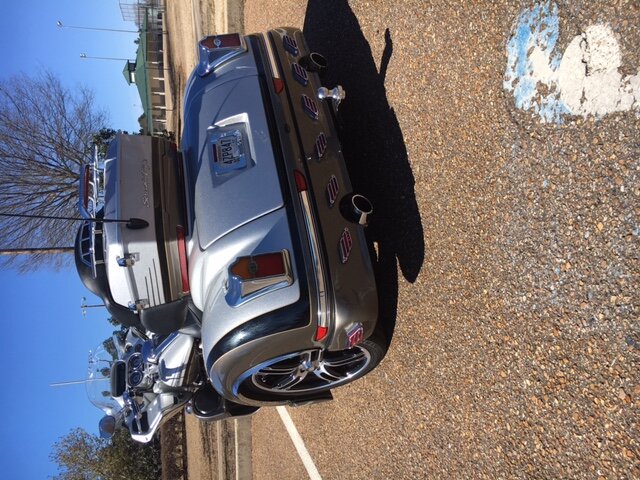

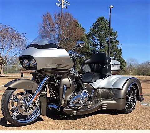

My CVO conversion
Rockie , You can check out my Screamin Eagle CVO conversion that CSC (trikes by Rodney ) did for me. Just check out some of my post and you can see the quality of work they do. I couldn't be happier with the fit and finish and the customer service the provide. The paint was done by Lemon Designs.The pics don't say enough for the ride and feel that the trike has. I did a lot of research before I made the conversion to the CSC . Best move I ever made. sun5.JPGsund.JPG
Hi Boog,your CVO looks amazing.did u ever hv trouble with lifters going on your engine or the engine paint chipping.Id love to trike my CVO but looking at CVO site a lot seem to hv problems with booth.from 2007 up.if I go with Tri glide I’m loosing all the CVO stuff plus independent rear suspension but will hv Harley guarantee.The CVO trike is a one off though 😳
cvo conversion
Rockie, I have not had any problems with the paint or lifters. I have seen on some Harleys that one lifter may go bad but not all at one time.You could have a problem with the run out or play in your cam bearings causing the problem for all lifters to go bad. Yes I would keep my CVO and trike the CVO. Now this is my opinion I would trike the CVO with the CSC conversion and you will have the best riding independent suspension offered on the market. Hate to think of a rigid rear axle and trying to run through curves and the handling ability you will miss. Judt more than happy with my conversion after many hours or research. Have a great day. Booggerbe (Ron)
