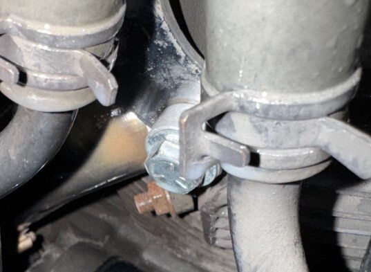

I had the neck bearing replaced at the 50K checkup because of some occasional clicking coming out of the fork area. I don’t have the original set of bearings. The wobble didn’t actually start until at maybe 54K. I’ve got 56K on the trike so the problem hasn’t been around that long. Two shops said they thought the issue was being caused by bad bearings. It wasn’t until a third tech noticed the shaky motor and missing bolt that the problem was identified and fixed. The attached pic shows the replacement for the broken bolt. Two other bolts are down and to the left of the top bolt. They’re really hard to see because they’re painted black and it’s dark up there! From now on I’ll know what to look for during routine maintenance.

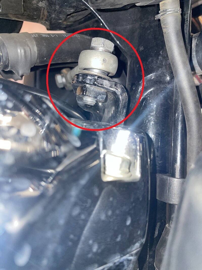

I had a failure of the same part about a month ago.
I noticed an intermittent squeak on my `22 Tri Glide, It turned out to be a broken engine stabilizer bracket that is bolted on to the front cylinder head.
I was on a road trip, about 1,000 miles from my home in SC.
I called a local dealer, they did not have one in stock, so they overnighted it and I brought the bike in the next day, it was replaced (and bike washed) in 90 minutes.
Covered under warranty.
Thanks to Harley Davidson of East Hartford Ct.
Note: In the first picture below, you can see the nut (that is supposed to be welded onto the bracket) is missing.

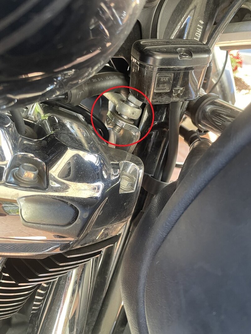

The second picture shows the new bracket.
New bracket
