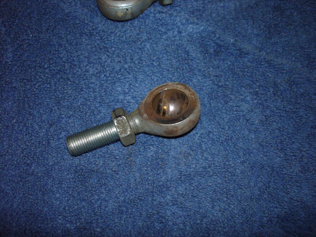

One of my rod ends started rattling at 30K. As I do not have any warranty, I just replaced the rod ends on stock bar. Old ends were steel on steel and had rusted.

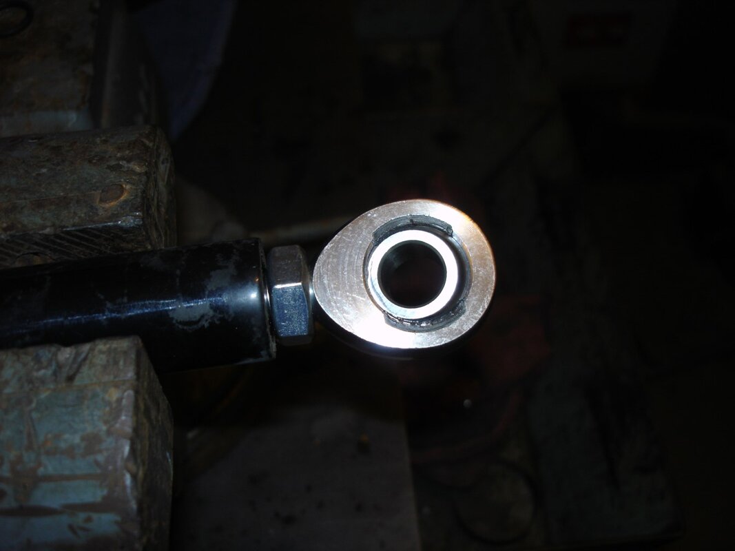

I put rod ends with a Kevlar/Teflon race. Sourced locally with jam nuts for under $30. Harley just replaces the whole new bar assembly with steel on steel race.($200) Yes you would think they would last longer but you also see allot of 3 or 4 year old TGs for sale with lots of options and little miles on them. Best option I find with mine is to add miles to it.

Rod ends here: http://www.qscomponents.com/12xmr.html
Dennis, Did you remove the body to get the rod off? Manual says to but it looks like there's enough room to wiggle it out. Was it much of a job to re align the rod? Willie
